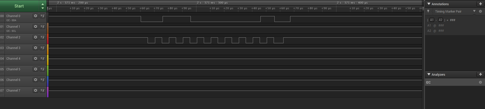

The next picture shows the activity in the I2C bus:

Using a scope, do you see the proper address on the bus ?

According to the image I attached, the address seems to be transmitted correctly: [start condition - 0110000 (address) - 0 (read operation) - 1 (Not Acknowledge) - stop condition]. But at the last clock pulse, data is high, what stands for a Not Acknowledge.
2017-12-20 8:30 AM
The lack of an ACK indicates nothing on the bus recognizes the address. Triple check the wiring and power for the slave peripheral you expect to respond. Check the address selection bits on devices that support that. Make sure the pins are in OD mode.
