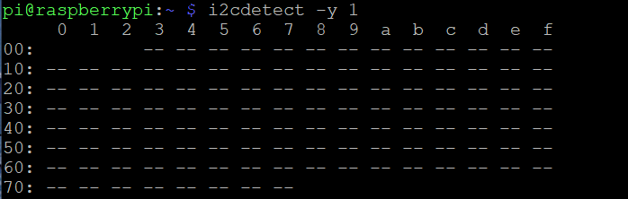

Hello all, I am new to the STM32 environment. I have a Rasberry pi's I2C lines connected to a NUCLEO-L552ZE-Q on the I2C2 peripheral on pin PF0 and PF1. I have set up the address to 0x50. I have attached a text file showing different instantiations and declarations on my STM32 I2C initialization. But whenever I try to detect the I2C the pi does not detect it. Any advise would be appreciated. Thank you

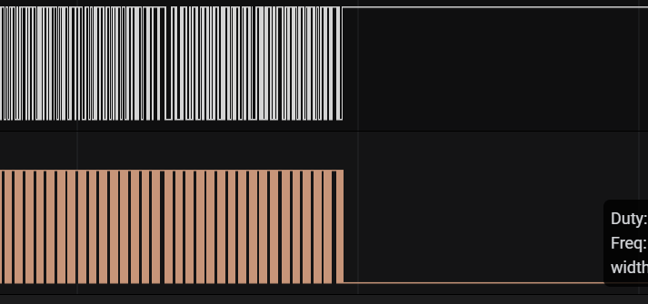

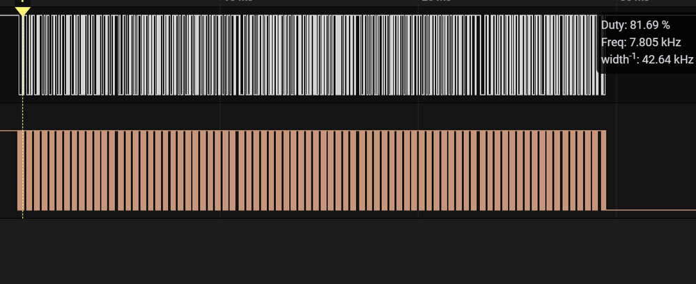

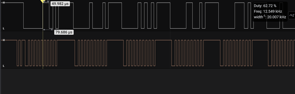

Hello, Thank you for your time and reply. Here is a screen capture from a logic analyzer.
Sorry I am still confused. I am trying to get an address acknowledge. Shouldn't my initiated interrupt, handle that for me? These 2 lines are my interrupt instantiation.

I also think my SDA line is always low after the data has been sent by the pi. But the SCL comes up. The SDA comes back up only when the reset on the MCU is pressed. Which makes me not confident about the instantiation of I2C in that text file. Please correct me if I am wrong
