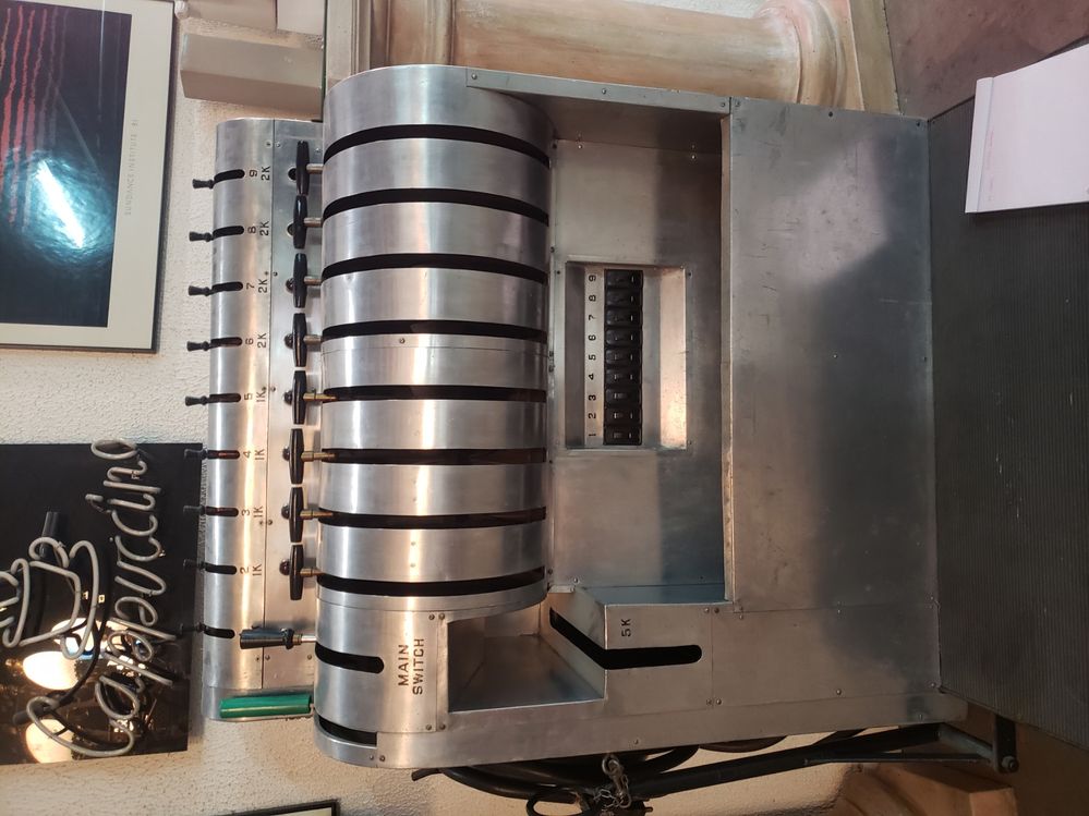

I have a old dimmer rack that is used just for decoration but is also a really cool piece of film history. As a project to learn more about embedded development I wanted to make it more interesting to look at. It has nine incandescent indicator lights that I am switching over to nine white LEDs that are being driven by a nine channel LED driver (LP55231) via a STM32G0 to create interesting lighting sequences.
