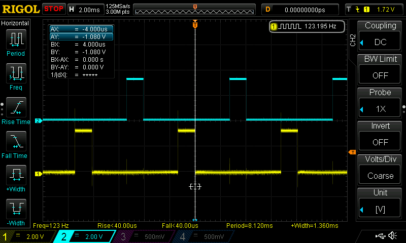

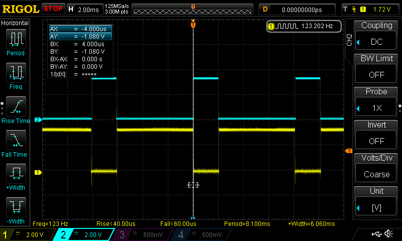

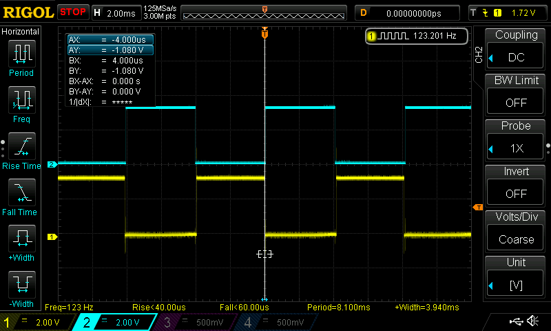

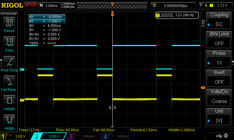

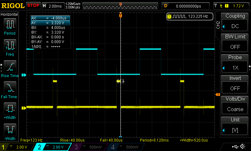

I need 8 pwm ( 1out+1Nout ) x4 = 8
with 8 different duty cicle and 4 different dead timeI share some images for the waves that I need:
fig2-outX_balance_100pctPower
fig3-outX_unbalanceDown_20pctPower
fig3-outX_unbalanceDown_100pctPower
fig4-outX_unbalanceUp_100pctPower
fig5-outX_balance_50pctPower
so in this case I will need 8 timer I don't know if stm32f051 has these feature.
