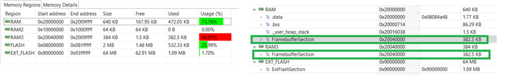

This MCU is having 3 RAM sections:
RAM : 640KB,
RAM2: 64KB,
RAM3: 384KB
I have modified my linker script(attached here) but don't know why the framebuffer is stored in RAM as well RAM3 section as per below snap?
Linker script: STM32L4R9AIIX_FLASH.zip
Following is the part of touchfgx generated code to store the framebuffer at the TouchGFX_Framebuffer location.

Please help me to store the frame buffer in section RAM3 only as I want to use RAM/RAM2 for other operations.
2023-01-24 5:59 AM
Simple because RAM3 overlaps RAM.
2023-01-24 5:59 AM
2023-01-24 10:55 PM
Thank you @MM..1 for taking my attention towards the memory map of this MCU.
This MCU has a total of 640KB(RAM1:192, RAM2: 64, and RAM:384).
