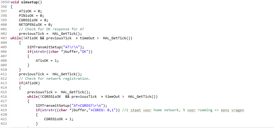

In my code i first setup the sim7600 using blocking mode and later switch to dma. But in blocking mode I'm having trouble receiving data over uart. Using a nucleo it sometimes works very reliably and other times doesn't work at all or it only receives the first letter. on my custom board i once was able to get at ok response but other times it was nothing or some random character. What could be the reason?

sorry, here it is:
that good enough? i can put in the entire code as well if that is better

There is no way to know what you're doing in SIMTransmitSetup? Post your code as a Code Snippet.
