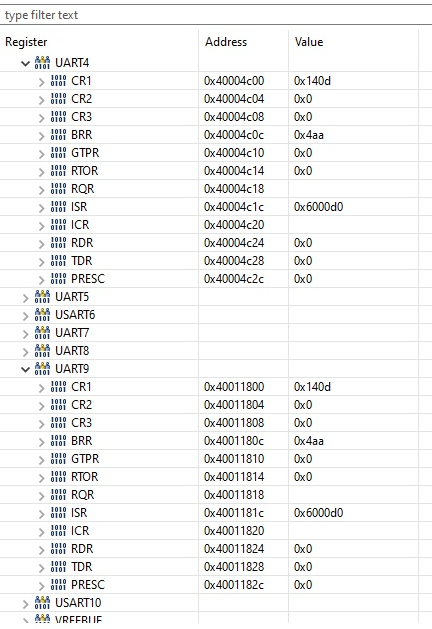

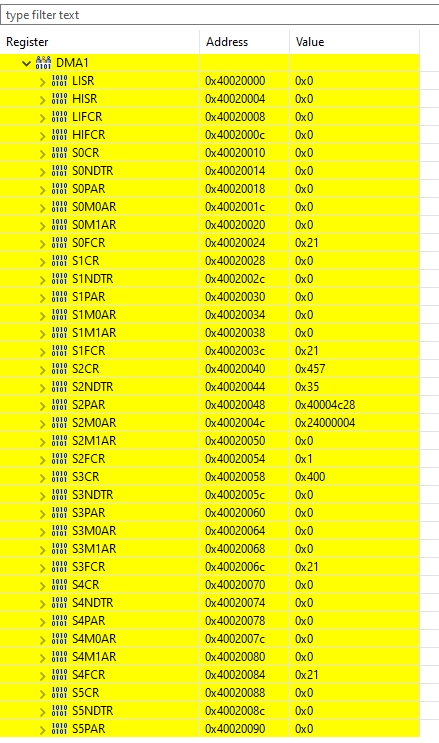

2021-12-22 9:54 AM
Do these help?

Those values aren't consistent with the code you presented. The DMA1_S0M0AR register (among others) is 0 but clearly it's being set in the code:
> LL_DMA_SetMemoryAddress(DMA1, LL_DMA_STREAM_0,(uint32_t)aUart9TxBuffer);
If the clock wasn't enabled, stream 2 values would be zero. Step through the code and verify these values are getting set on the appropriate line.
I could be missing something but don't think I am.
That does not mean the clock is enabled while writing into Stream0 and Stream1.
2021-12-22 4:36 PM
If the registers are shown at the end of the initialization code shown, it does. Which is what I requested. But it's entirely possible that's not where they were taken.
DMAT also isn't set on either UART4 or UART9, so it's unclear how UART4 is "working".
