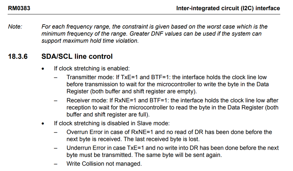

code is compile and run ok no error exist but not work in stm32f411,
and same code work in stm32L476RG.
I'm observe when I'm enable stretch mode enable in stm32f411 I2C reception is working ok, but in transmission garbage value. I don't know why its happen.
please guide me.

Clock stretching is particularly useful in situations where the slave device might have slower processing capabilities compared to the master or when it needs more time to access external resources such as memory or peripherals.

Hello @DGhod.1 ,
