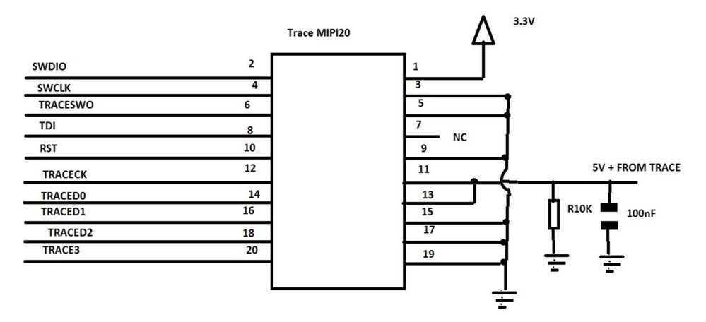

After carefully connecting all the wires keeping in mind MIPI20 connections on Nucleo144 STM32F767. I am able to power and program the board using trace but when I enable ETM and then debug things start going wrong.
My Connections configuration is as follows :
PIN Name ---- Connector Pin ZIO --- Function
PE2 D56 TraceCLK
PE3 D60 TRACED 0
PE4 D57 TRACED 1
PE5 D58 TRACED 2
PE6 D59 TRACED 3
PB3 D23 TRACE SWO
PA15 D20 JTDI/TDI
3,3V Vref
PIN Name ---- Connector Pin Morpho--- Function
PA14 15 SWCLK
PA13 13 SWDIO
RESET NRST NRST
+5V 6 TPWR

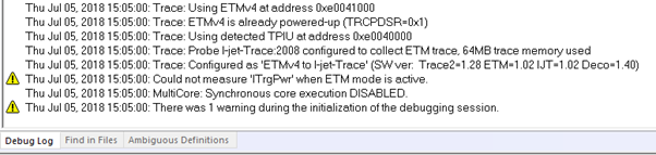

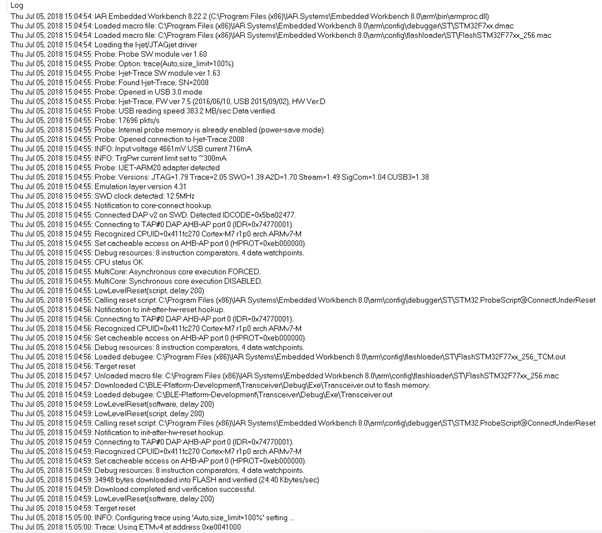

I get the following Debug Log output before starting ETM debug:

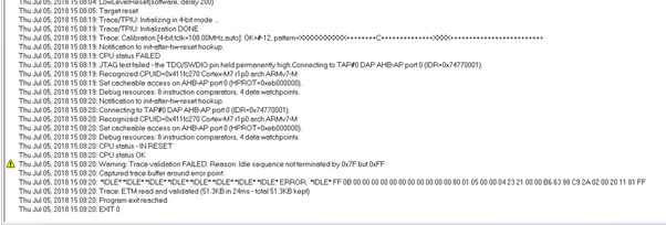

Debug log after ETM enabled and Debug started from main:
Please help me with that as we could not figure out so far what is going wrong.
One thing we are not sure why TDO/SWDIO is always high in the debug log and verified in actual.
Keep in mind we have cut the ST-Link part of the Nucleo board.
There is an ARM20 connector in between as well but we have customized board from which we are able to provide all the required connection for the MIPI20 configuration as follows.
