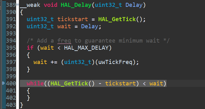

2022-04-27 6:38 AM
Probably your SysTick interrupt is same/lower priority as your EXTI interrupt, so the code just stalls there during HAL_Delay.
Having a 2s blocking delay in an interrupt isn't a good practice.
In any case, debug your code. Run it, wait for the bad event to happen, hit pause, and see where the code is at.

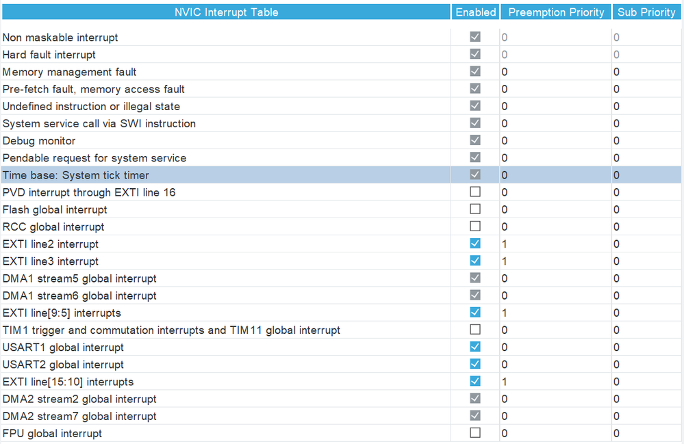

2022-04-27 7:37 AM
The Preemption Priority of Time Base: SysTick Timer was setted to 15 (default) meanwhile all the others to 0.
Now I set SysTick Timer Preemption Priority to 0 and the EXTI to 1.
This solved the problem but i noticed that the LED remain turned up for something more than 3 second insted of 2.
