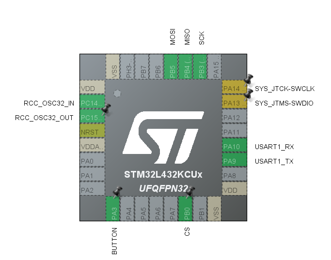

Where are you getting stuck? Provide some context instead of just dumping code. Can you view signals on a scope?
2022-01-19 1:49 PM
I cant send signals to the leds. I also cant see signals, because I am not sure, if I use the Logic Analyzer right.
2022-01-20 12:50 AM
Have you already taken a look at the MAX7219 datasheet? It is operated with 5V and needs at least 3.5V to recognize a logical 1 at the logic inputs.
The STM32 runs at 3.3V and is 5V tolerant on many pins, but then you also need to select/program the correct GPIO mode. However, the GPIO initialization is not visible in your code listing, so nobody can know what you have set there.
Devices that work with 5V logic, such as the MAX7219, must be driven with open-drain and pull-up.
By the way, you've essentially asked this question before, haven't you?
Regards
/Peter
2022-01-20 5:40 AM
I know this fact. Yesterday I was going the configuration with my teacher through and he said, that it is fine and that the 5V thing is not "necessary", because it worked also from other students. The proble ist just in the code and I think its the write_byte function.
Yeah, I asked this question before.
Regards,
Srdjan
2022-01-20 5:59 AM
Consider what parameters HAL_GPIO_WritePin expects and what you provided in write_byte.
Hint: result of the masked value vs. required parameter
But again - it's purely coincidental that it works if you want to drive a 5V CMOS input with 3.3V CMOS levels. This can also be configured with code, so it's also something like "just in the code".
Regards
/Peter
2022-01-20 6:02 AM
So you mean I should set the value first and then send it via HAL_GPIO_WritePin?
I also changed now the pins on Pull Up and CS on Open Drain
2022-01-20 6:16 AM
No, I gave a tip so that you can at least find one error (if there are several, which I haven't checked yet). The tip is that you have to look at what HAL_GPIO_WritePin wants as a parameter and then compare that with your passed parameters.
Well, the first two parameters are quite clear and - you'll agree - correct, right? (well, hopefully, because nobody here knows what you have connected to which pin).
Then what about the third parameter, which you calculate directly in the call (which is of course allowed) - what does HAL_GPIO_WritePin want to see there and what values does your calculation result in?
2022-01-20 6:46 AM
The HAL_GPIO_WritePin wants to see just 1 or 0, so this line i "garbage". But how I can write the data to lets say D1 otherwise?
