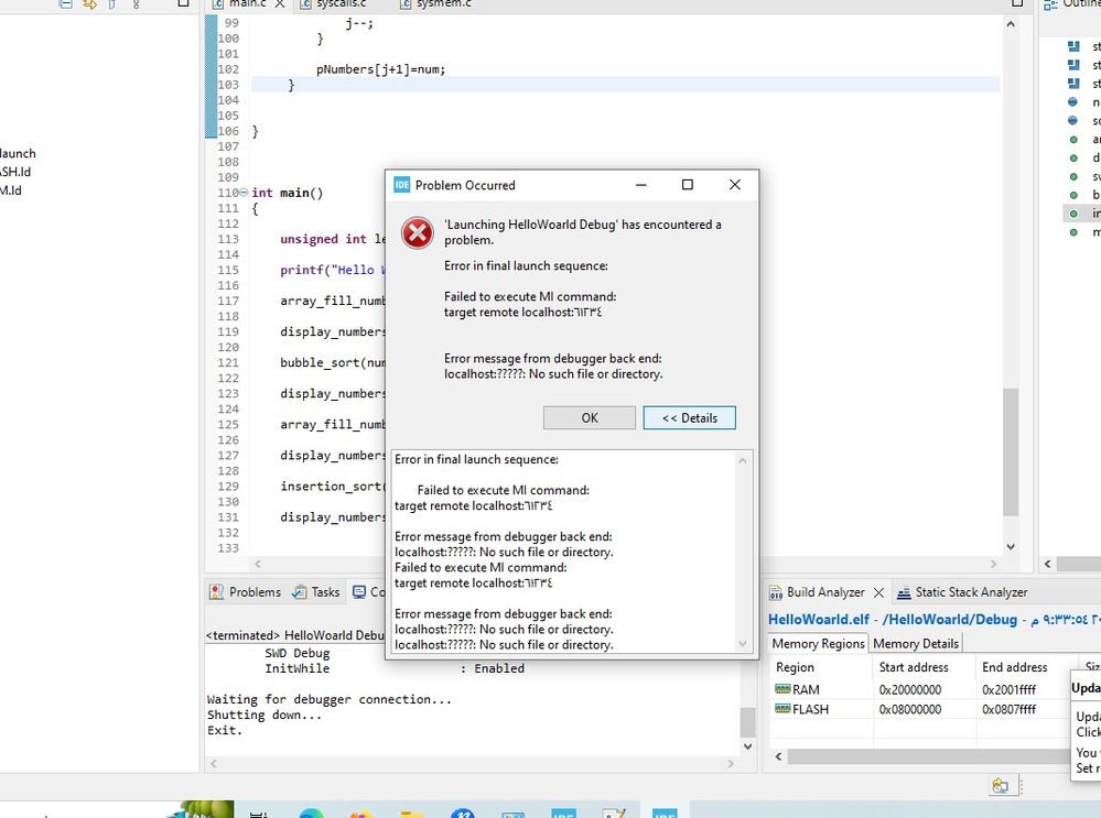

I am using STM cubeide version 1.11.2 on windows 10 when i creat a project it is working without a problem if i closed the ide and open it again the problem occur
2023-03-23 4:24 PM
2023-03-23 4:25 PM
this a photo for the error
2023-03-24 10:52 AM
Fixed in second thread, switch Windows numeric from Arabic to English notation
