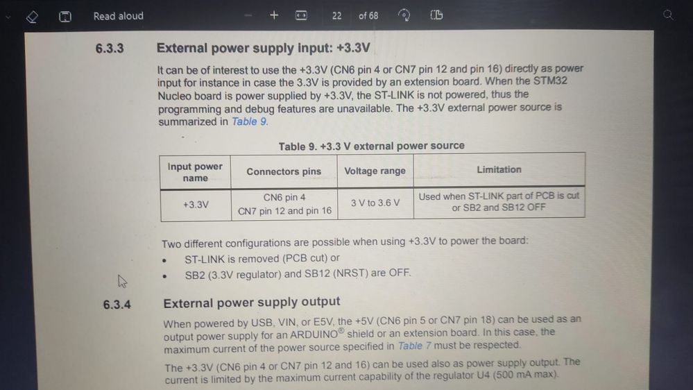

i only use the top of this l053r8 card and what is the reason for this and how can I get 3.3 through vdd target.

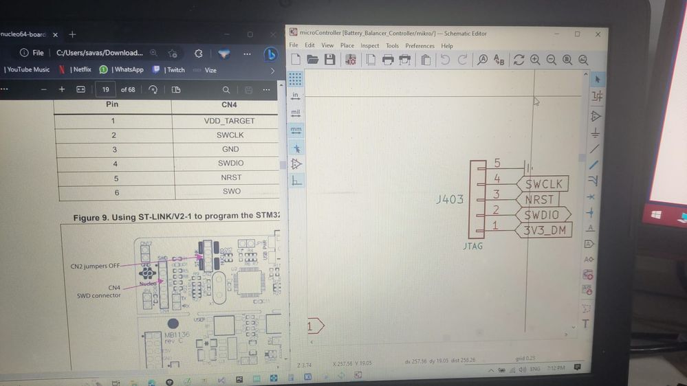

i want to run a different card using the swd part st-lik. i want to get the power of this card through vdd_target. Part of CN4 Also, there is no entry on my other card.

You want to to power YOUR card via the USB source?
Check circuit diagram, and JP15 ?? jumper pads.

There is no usb port on my card that I want to run, so I want to transfer the power from the swd part of the L053R8 card to my other card.
and the L053R8 board only has the top part so I can't use the 3.3 v on the cn6 at the bottom
