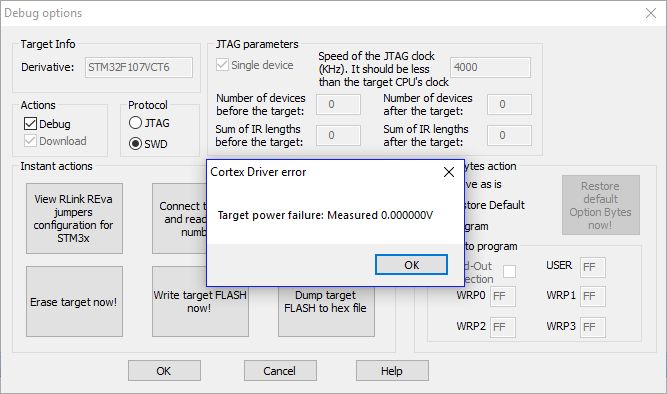

I bought a development board -STM3210C-SK/RAIS [Development Boards & Kits - ARM Raisonance]. I intalled the Ride 7 from the CD in the package, set up and confirmed all jumpers then opened an example - QuickStart_STM32F After I clicked the Project -> Build Project command, there is an error saying that ''Target power failure: Measured 0.000000V.

In Debug options window, if I clicked

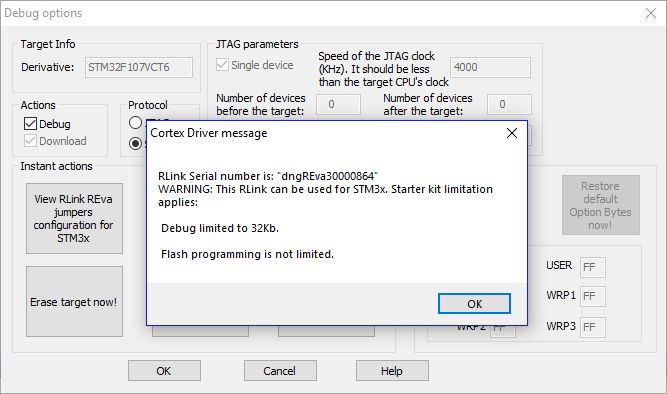

“Connect to Debugger�?, then:
I assume that the board has already connected with my computer.

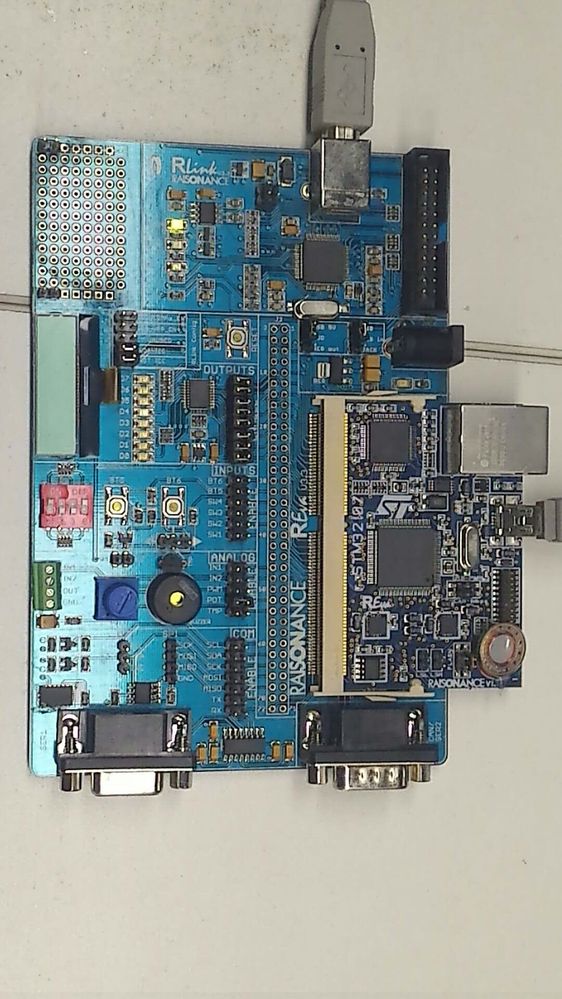

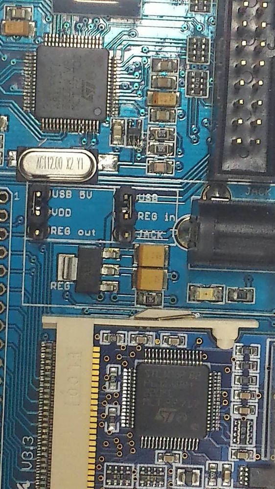

This is my board:

But to your issue - might it be that the target is really not powered ?
Not sure if the Raisonance debug pod can power a target, but surely not such a large one as depicted.
Check the dev board manual for power supply options, and supply it externally.

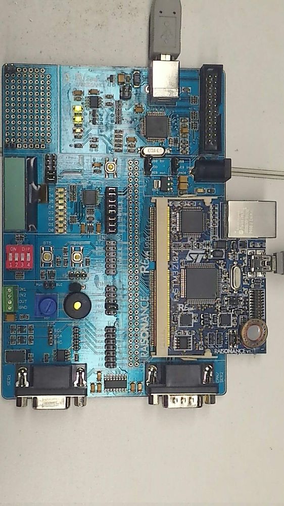

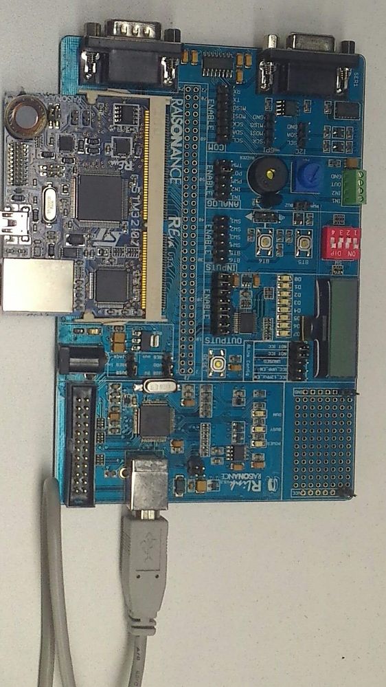

Thank you very much. Actually there is another cable to connect to the daughter board from computer. I didn't connect it in the picture. But it's no help. No matter it is connected or not, there is always such error. I changed to a new cable but it doesn't work. I thought about supplying it externally but I couldn't find a manual in anywhere (CD or paper or website). I'm now thinking to return the board and get money back. Thanks anyway.

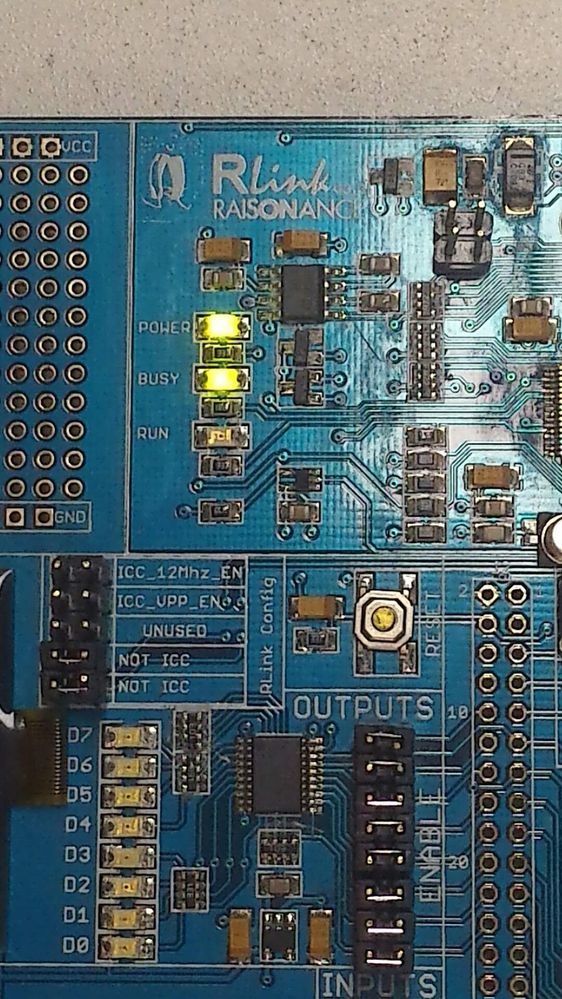

As you said, there is a power LED. And it is on after I plugged in USB cable to development board. Now I plugged in the other cable to daughter board on lower right of picture.
I checked the power jumpers according to quick start sheet. USB 5V connects with VDD and USB connects with REG in.
Then I started the Ride 7 software and click connect target button in Debug options window. The error showed up. And the busy LED is turned on and never turned off.
The seller insists that the board is good and some jumpers or software operations need to do then problem will be gone. I sent an email to Raisonance and asked for help. Hope they can give me solution.
