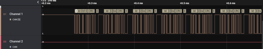

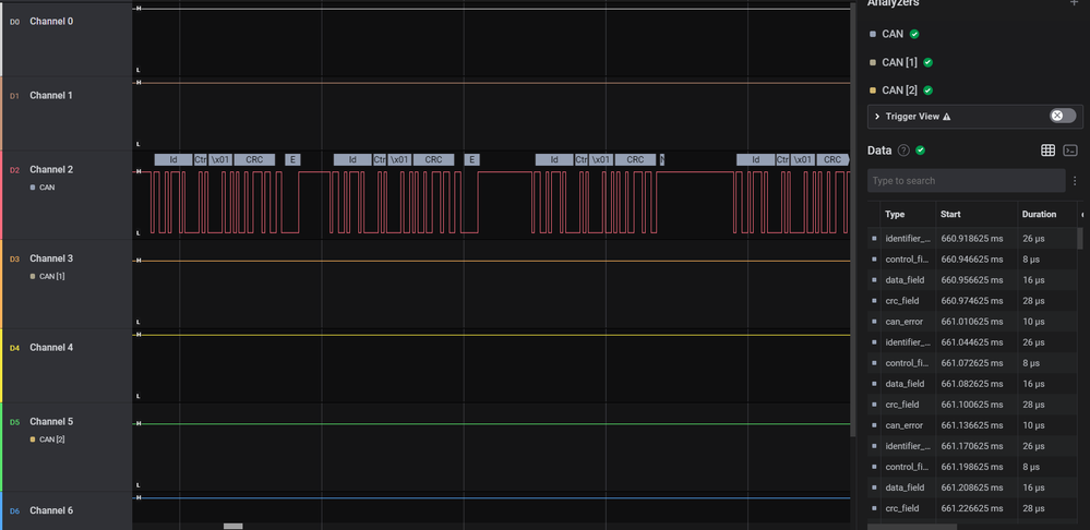

As you can see due to i can't receive the required ack from N2 node, N1 node It keeps sending the same message. Then HAL_ADDTX function returns HAL_CAN_ERROR_PARAM because the transmission is not happening and all mailboxes are full. Also i request TERR0 because of Transmission error of mailbox0.

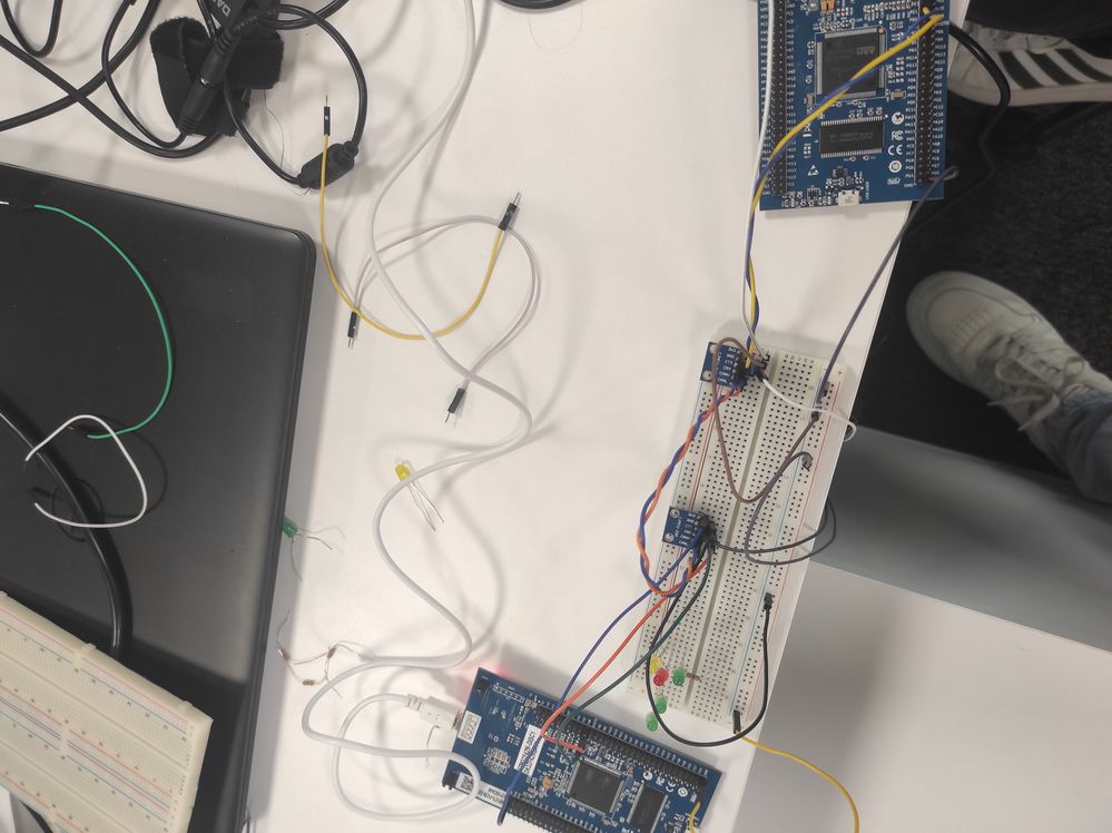

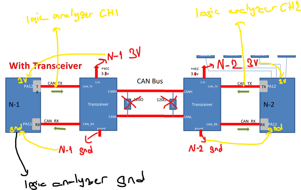

Nobody has any idea what STM32 you're using or how anything is wired.
Guessing STM32F429-DISC board of some revision. Aren't the CAN pins conflicted?
Diagram the circuit, identify the pins, show the code.

And i'm reading this on logic analyzer CH1. Tx message cant transmitted so keep repeating.

I didn't use 120 ohms because my transciever module has it.
