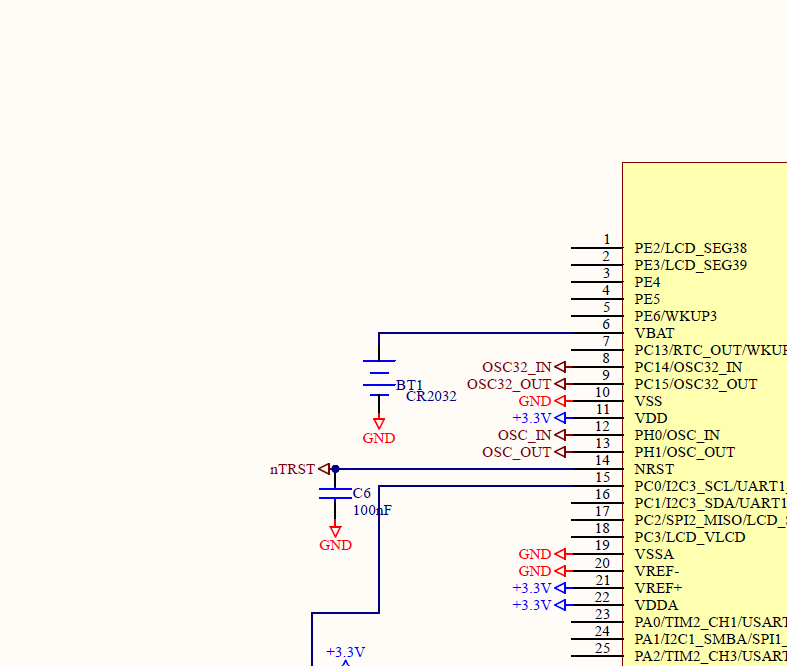

What causes the external disturbance to make it latch-up. Do you have adequate isolation?
2022-07-17 10:22 PM
BOOT0 pin ? External clock ?
2022-07-18 1:51 AM

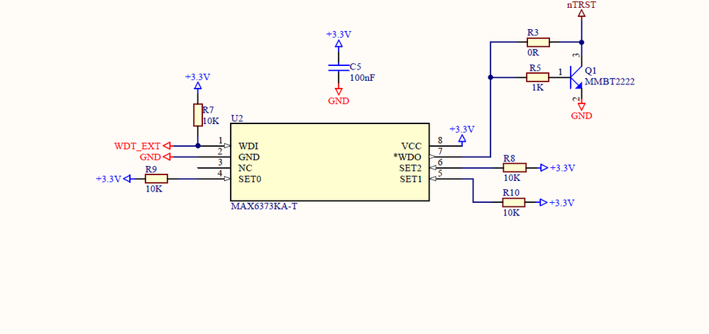

It is used in a high voltage generating circuit that ignites. It is expected to be unlocked, but we expect it to come out of the lock with NRST. NRST is triggered by wdg.
2022-07-18 1:54 AM
BOOT0 pin connected gnd. HSE oscillator
