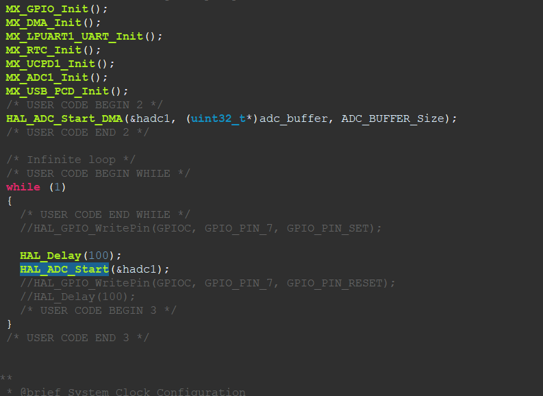

/* USER CODE BEGIN 2 */
HAL_ADC_Start_DMA(&hadc1, (uint32_t*)adc_buffer, ADC_BUFFER_Size);
//HAL_ADC_Start(&hadc1);
/* USER CODE END 2 */
/* Infinite loop */
/* USER CODE BEGIN WHILE */
while (1)
/* USER CODE END WHILE */

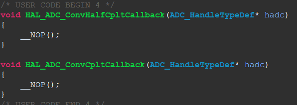

void HAL_ADC_ConvHalfCpltCallback(ADC_HandleTypeDef* hadc)
__NOP();
void HAL_ADC_ConvCpltCallback(ADC_HandleTypeDef* hadc)
__NOP();
