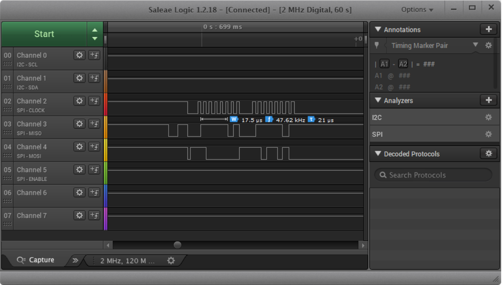

2021-05-17 12:00 PM
I tried adding a delay in the interrupt handler, and it still doesn't seem to work. I've attached an image of what I'm seeing, it seems like no matter how large the delay is, that is what my output always looks like. The data the SPI is reading in is also one bit off, I assume for the same reason. Shouldn't it be waiting for the clock to continue sending data? I'm a little confused how this is supposed to work at all.
Note: I am testing using another SPI on this board as the master. Is there any reason that simply wouldn't work?
Thanks again!!
Charles
2021-05-17 1:27 PM
I've resolved the issue, it ended up that I needed a pull-down on the SPI clock to keep it low at startup.
Thanks!!
