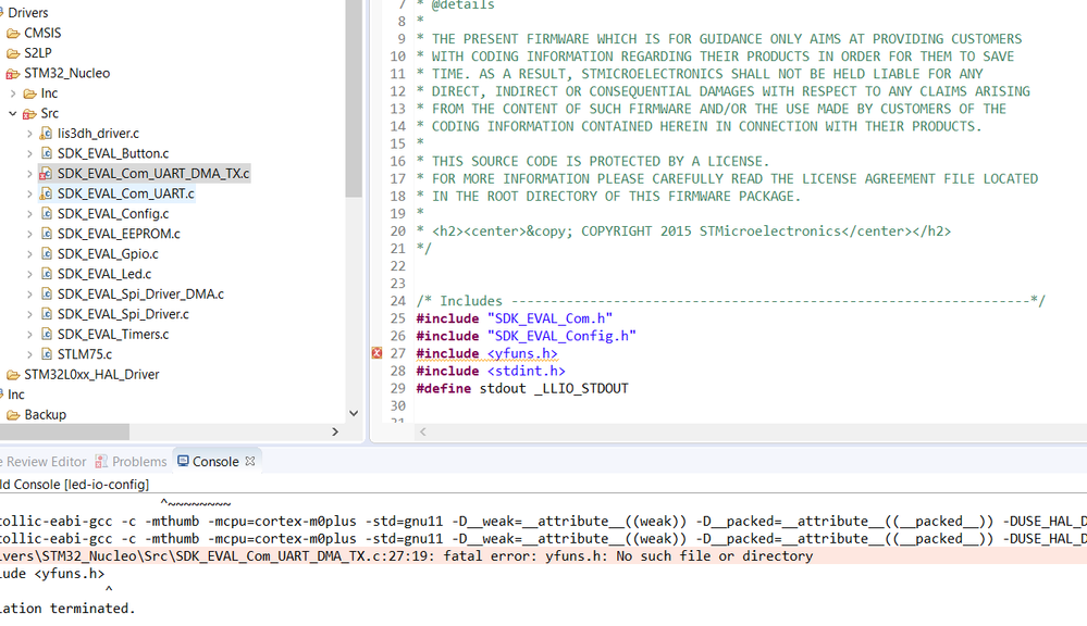

I am trying to run the S2-lp SDK example project on truestudio but I am running in so many errors. one of them is that the yfuns.h file is not even the directories.
2018-10-10 10:25 PM
I don't know this SDK, but it seen your project is not properly set up.
Have you tried to locate this missing files, and add the appropriate path(es) to te includes ?
2018-10-11 7:39 AM
Do you mean this: https://www.st.com/en/embedded-software/stsw-s2lp-dk.html ?
As @Community member suggests, the commonest reason for not finding header files (when they do actually exist) is that the Include Paths are not correctly set.
