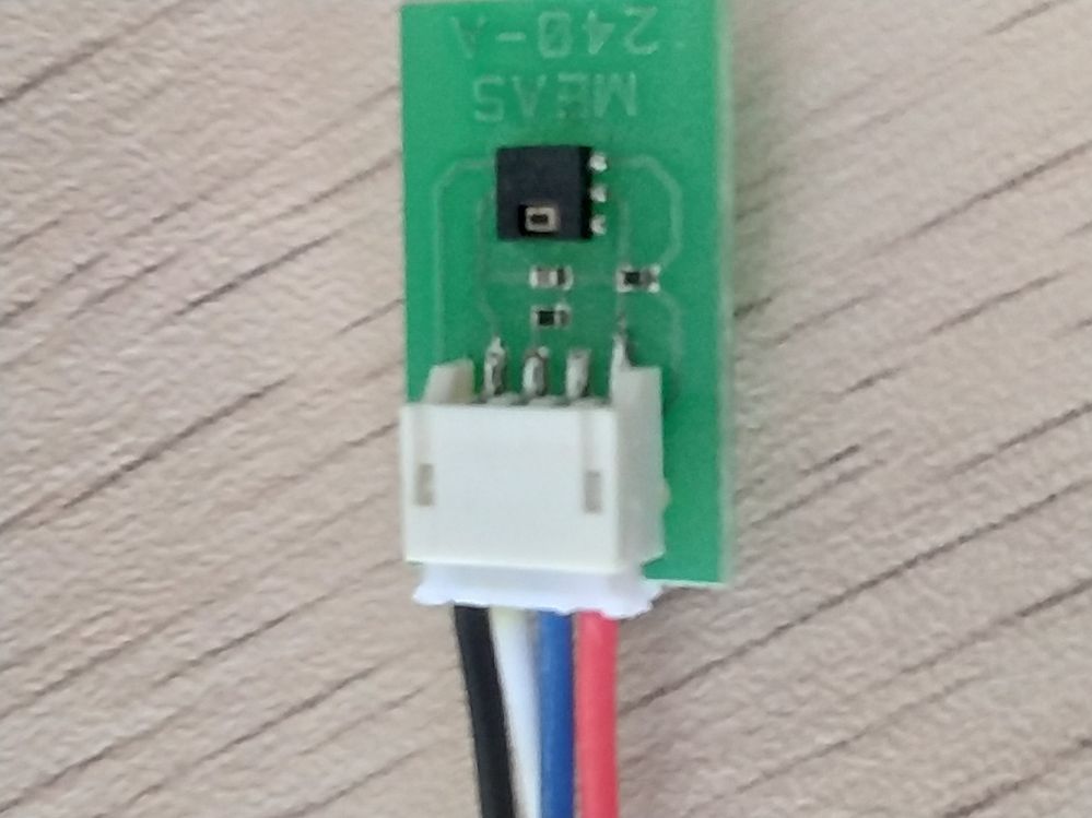

Connection of HTU21D sensor and Nucleo-L152RE board are:
SCK --> PB6
SDA --> PB7
VCC --> 3V3
GND --> GND
Attached snap shot of interface between sensor and Nucleo.

  • Here I attached full interface snapshot of NUCLEO-L152RE with HTU21D sensor and main.c file. In the snap -shot you can find that there is pull-ups present on SDA and SCK line. So, can you please guide me how to solve this issue to read proper temperature data.
