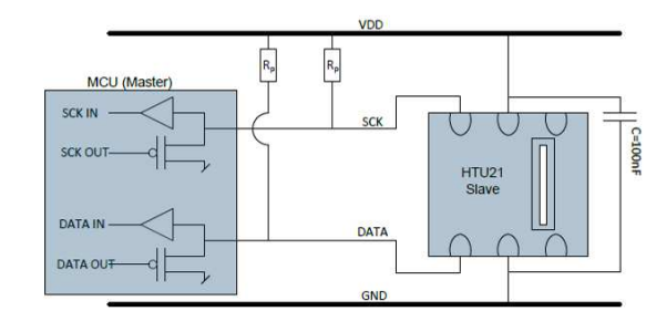

Connection of HTU21D sensor and Nucleo-L152RE board are:
SCK --> PB6
SDA --> PB7
VCC --> 3V3
GND --> GND
Attached snap shot of interface between sensor and Nucleo.

As far pull-ups, it is present on SDA and SCK line on PCB. And after debug, I have found that in HAL_I2C_Master_Transmit() "I2C_WaitOnFlagUntilTimeout(hi2c, I2C_FLAG_BUSY, SET, I2C_TIMEOUT_BUSY_FLAG, tickstart)" this is returning the HAL_TIMEOUT error so HAL_I2C_Master_Transmit() gives the status HAL_BUSY. Now, what is the next step to do?. Can you please guide me.

Here is the IOC file. HAL_I2C_Init() is called in MX_I2C1_Init(), it is already present in code but unfortunate I forgot in snippet code.
Also attched HTU21D interfcae which is already present pull-ups on I2C lines.0690X000006CsHnQAK.png
