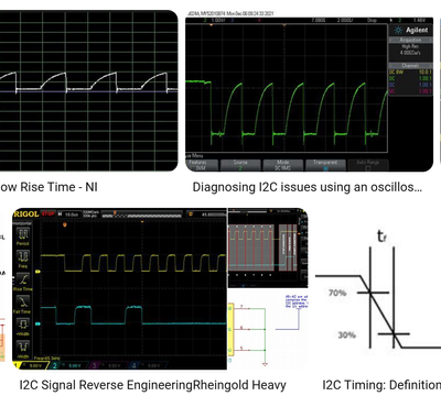

> Take a conservative estimate of rise time as being 1/20 of the clock period.
I'm not sure how familiar you are with I2C. It seems like you're taking what you would expect with SPI and applying it here. Take a look at I2C timing traces on the web and you'll see that 1/20th of the clock period is in no way conservative. Here's two relatively slow ones and one that looks better:
Which is why I say seeing the traces would be informative.

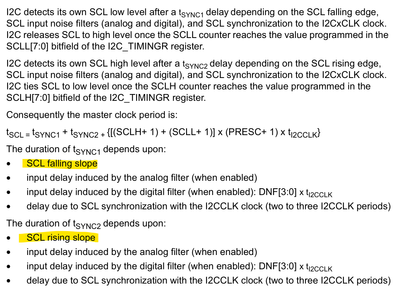

Clock frequency on I2C is not exact as the STM32 needs to wait for edges to happen (as the I2C spec requires). The reference manual even states this. It's not an open loop system like UART or SPI.
