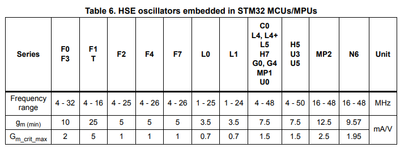

In AN2867, we provide the requirements for resonator selection:

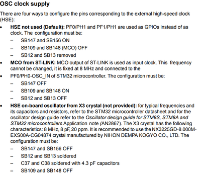

And we suggest an example in UM2179, while we don't provide it by default in the board NUCLEO-L4P5ZG:

Hi. @Amel NASRI Thanks for the recommendation, you refered to this crystal right? (attached image below)
One question here is that I can select another crystal with the same characteristics, i.e. same load capacitance, shunt capacitance, ESR and use it instead the model (NX3225GD-8.000M-EXS00A-CG04874[N/A]) proposed in the document you mention?
Another maybe basic question but what does men the curve line in each line (OSC-IN and OCS-OUT) respectively?
