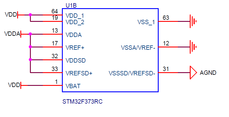

My MCU does not work. I guess it is oscillator problem.
- PF1 pin of STM32F373RC is low even though 3.3V power is supplied to MCU, so 8Mhz oscillator does not work.
- The oscillator has internal capacitors and part number is "CSTNE8M00G550000R0"
- I designed this circuit board. I used MCUs of Atmel, TI and Microchip for several years but this is first time to use STM32 MCU.
- I checked 3.3V power is normal and NRST pin value is HIGH.
- There is no other oscillator for LSE
Did I make a mistake?
Please let me know some way how can I check this issue.
Attached image is oscillator part of my circuit.

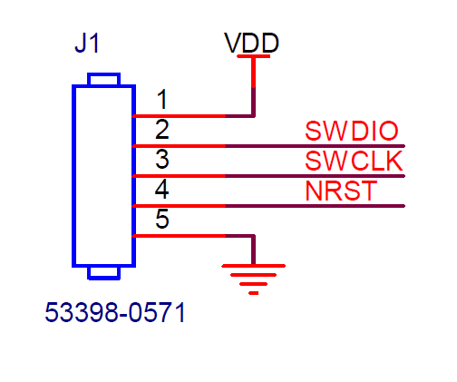

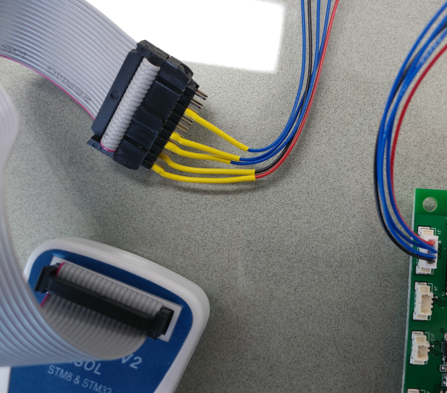

Attached images are emulator connection

Check level of NRST
Make sure you have VDDA connected to a supply
Power/wiring of SWD looks ok.

I found something strange while checking NRST level
Voltage of these pins are changed after trying download firmware by emulator
First value is measured before connect emulator, second value is measured after download is tried.
SWDIO: 3.3V --> 3.3V
SWCLK: 0V --> 2.4V
NRST: 3.3V --> 2.8V
NRST and other values become normal after emulator connector is detached. My emulator has some problem?
2018-09-24 9:27 PM
You'd need to review the AN2606 app note, but traffic on pins of interest will confuse the loader.
If the device supports USB in the loader, then with BOOT0=HIGH a PC should recognize the board as a "STM32 DFU Device"
Check that the ST-LINK reports seeing the target voltage. Generally speaking the kind of situation you are describing is where the core is not running/powered. Or you're trying to communicate on the wrong pins.

Hello @Diget ,
Dedicated pins for boot mode with USART2 are PD5 and PD6, you cannot use PA2 and PA3.
Make sure that you follow all recommendations provided in the hardware getting started of the STM32F373. The power scheme is particular as there are the VDDSD available only this line STM32F3 family.
You need to refer to AN4206 (Getting started with STM32F3 series hardware development).
https://www.st.com/resource/en/application_note/dm00070391.pdf
-Amel
2018-09-26 3:39 AM
Hello Amel
The mcu package I choose is LQFP64 and there is no PD5, 6 pins but there is USART2 peripheral. It is impossible to use boot mode with USART2 in my mcu then?
By the way I solved this issue. The problem was my emulator. I tried downloading firmware with Nucleo board as emulator and it worked well.
Thank you for your useful helps :)
