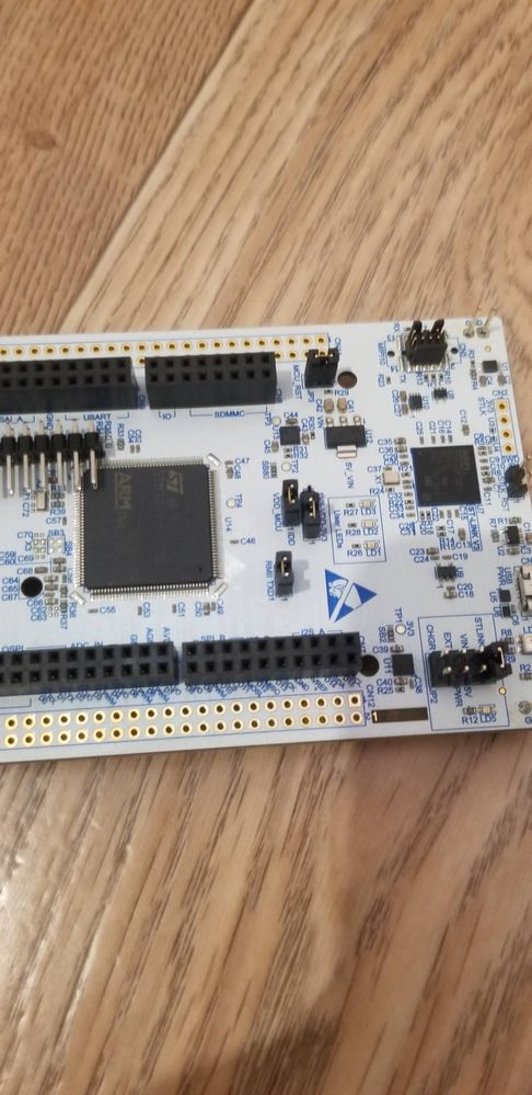

please do not be silent, dear inhabitants of the forum. I want to understand what the problem is. I'm trying to put the output into an active state using a master timer
HRTIM_SETx1R installed
MSTPER
HRTIM_MPER==1000
HRTIM_MCR installed
CONT
PREEN
MREPU
MCEN
this should GPIO_PC8 as the active output. but the master timer does not make it active.
only makes active
SST
MSTPER Master Period
The master timer counter roll-over in continuous mode, or to the master timer reset in single-shot
mode forces the output to its active state.
where is the error? Did I understand everything correctly?

MTS
Associate II
hi ) my the microcontroller broke down. I bought a new one.  I'll do the soldering and look at this timer again.
MTS
Associate II
 do you have a working HRTIM_PWM?
I set up the PWM on the PA9 leg for timer "C" PA9 set to AF2.
 in HRTIM_OENR included TC1OEN: Timer C Output 1 Enable
could there be an error with the HRTIM_SETx1R_FOR_"C" register address? the microcontroller does not react to actions with it in any manipulations.
I calculated the address as
0x400175BC
I have set HRTIM_MCR for timer "C". HRTIM_TIMxCR_FOR_"C" I have also configured.  the counter is working, the update happens. what else do I need to configure? do you know?
