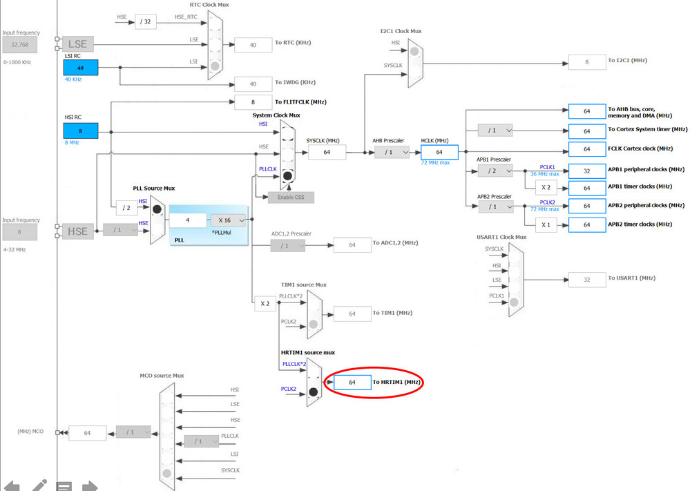

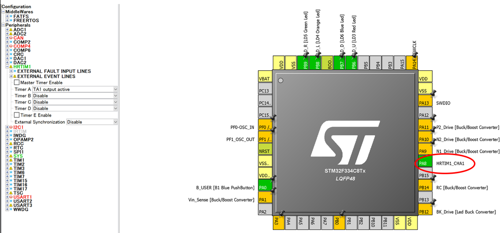

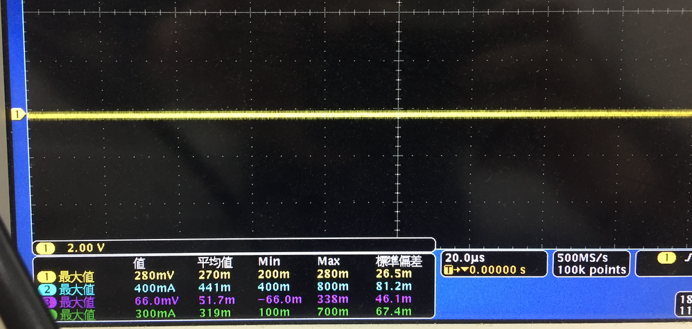

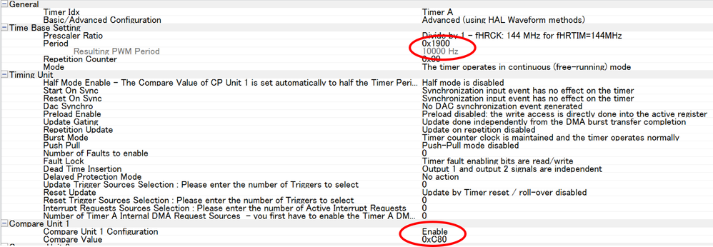

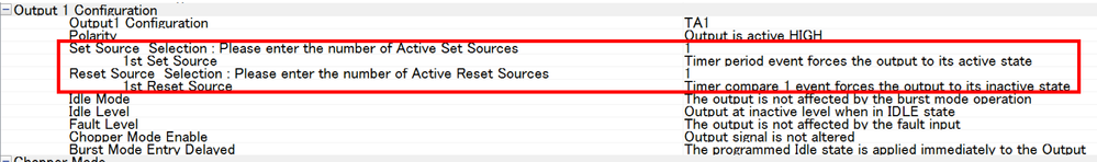

HRTIM does not work. I set up config as shown below.

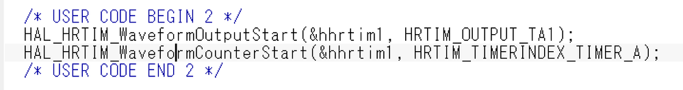

And, I wrote a program as shown below.
But

Hello
Inoue.Ken
,The functionHAL_HRTIM_WaveformCounterStart should take as parameter a combination of following values:HRTIM_TIMERID_MASTER,HRTIM_TIMERID_TIMER_A,HRTIM_TIMERID_TIMER_B,HRTIM_TIMERID_TIMER_C,HRTIM_TIMERID_TIMER_D,HRTIM_TIMERID_TIMER_E.
Please fix the call of this function in your code then try again.

2017-04-20 3:28 AM
Thank you very much. HRTIM work. If I were thinking by myself, I would not have noticed it. I was indebted to you.
