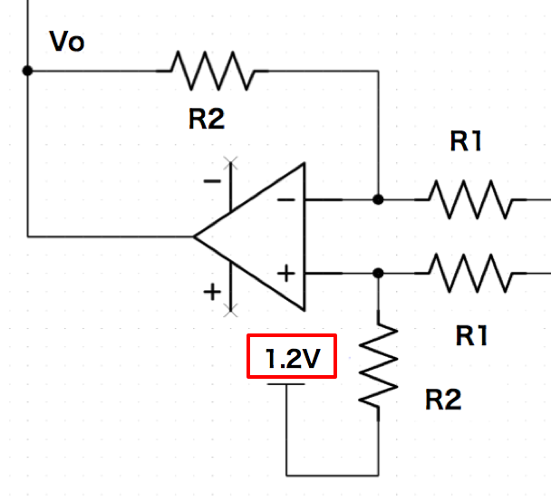

I want 1.2 V in operational amplifier circuit.
so, I want to use VREFINT as 1.2V.
But I don't know how to use VREFINT.
I don't know how to output VREFINT with Cube MX.
I am using STM32F334Nucleo.

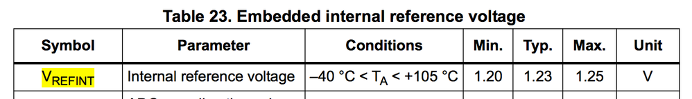

Posted on August 11, 2017 at 00:32
Hello Inue!!
Vrefint is an internal only reference voltage  in your case.
Other MCUs have the VREF as external pin.
But you can find
http://eu.mouser.com/Semiconductors/Power-Management-ICs/Voltage-References/_/N-10vu2?P=1z0wd7k
specialised voltage references for your need.
But I don't know how to use VREFINT.'
VREFINT can be readed  form ADC1, ADC2 as a normal channel .  Can be used also from internal comparators as negative input!!
Other use of VREFINT is to convert  readed ADC values , to real voltages.
Regards.

Posted on August 12, 2017 at 11:16
Thank you for your reply.
I'm sorry for my late reply.
I understand that Vrefint can not be used in my application,
Your reply is very helpful.
