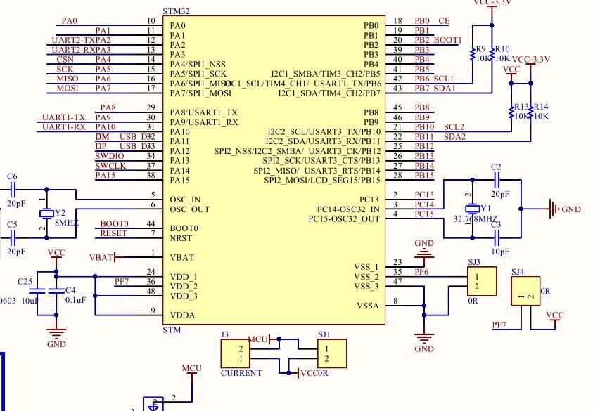

2019-11-08 6:58 PM
I confirm that all VDD VSS have been linked. The following is the schematic diagram. At present, when I use VBAT power supply, I find that there is 0.4V in the 5V power supply, which can exclude the peripheral circuit string. I want to know whether there is any need to set in the MCU
2019-11-09 4:11 AM
The internal switch between VBAT and VDD should be OFF, if the mcu is in reset (i.e. VDDA is below reset level)
Question is, whether the 0.4V is caused by open switch between VBAT/VDD, or some other parasitic path.
Is VCC-3.3V switched off (i.e. at 0V) together with VCC?
Can you also try to set some of the brownout flags and see if it makes a difference?
