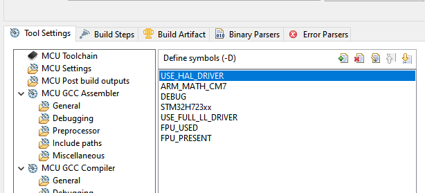

I did this:
And this:
Are those correct? All I want to do is to enable the FPU and then I want to call the functions I listed to use the FPU. I don't want to code my own math libraries or anything like that. I just want to be able to process the listed functions with the FPU instead of calling the software math functions which are slower than the FPU.

>Are those correct?
ok so. you set -mfloat-abi=hard , so compiler will use fpu . (no need to check..)

2023-05-07 12:09 PM
I know where the function is for the FPU, I just want to make sure what I did will enable it as I shown in the first picture. I added FPU_USED and FPU_PRESENT. Is this the correct way to do it in CubeMX?
2023-05-09 12:42 AM - edited 2023-11-20 6:12 AM
just for me..: i never added something in Cube for FPU !
its just a compiler setting, so set it ->
and it using FPU. thats all.
