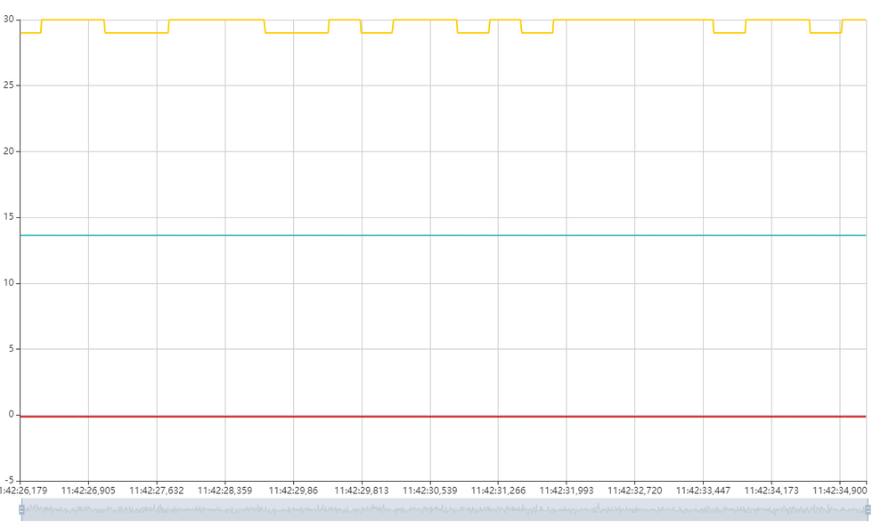

Hi @CPINA ,
When I read the values in array[0] without the for loop, I get these values (which are correct)

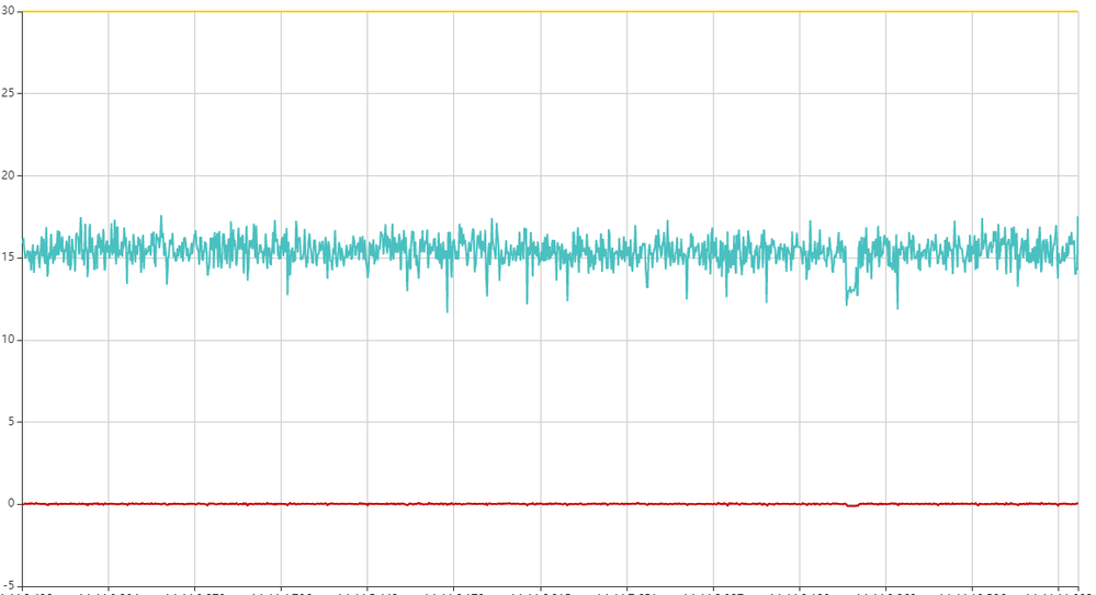

But when I replace the code with the for loop (nothing else changes) I get this data.
2021-07-06 6:48 AM
The blue line represent array[0]
2021-07-06 6:49 AM

2021-07-06 7:22 AM
Not sure to understand, for both blue line is your array[0) ? I was thinking it was the yellow one. what is supposed to be the data linked to array[0].
If the data line is supposed to be the blue one, it seems it is even not a data, looks like noise. Did you check that the SPI is well configured in debug just before writing the data into the data register ? Please confirm to me, you are master transmitter in such case ? If yes can you see the SPI going out after writing the Data register of the SPI ?
