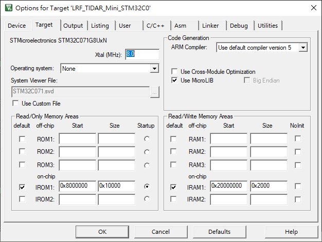

Then simply change 0x2000 (8k) to 0x6000 (24k)

Seems more as Keil question not STM. Show your sct file or memory config window in project... Spec is irelevant
2025-07-24 12:24 PM - edited 2025-07-24 12:41 PM
+1 Check the CPU Target in the project configuration pane (Device & Target)
You can also say the SRAM is bigger, until you get closure with the Linker, and then look at the .MAP to understand who/where/what is consuming it.
2025-07-24 5:46 PM
Thank you, this is my screenshot. The config is generated by CubeMx.
2025-07-24 9:18 PM
