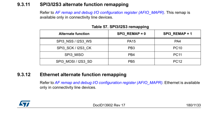

2018-09-08 1:45 AM
GPIO_PinRemapConfig(GPIO_Remap_SPI3, ENABLE);
I don't use 'F1, but looking into RM0008 it appears that SPI3_SCK is at PB3 when SPI3 is *not* remapped.
2018-09-08 3:12 AM
Thank you ~ ^.^ waclawek.jan
I was use like this. but work same (no SCK)
GPIO_PinRemapConfig(GPIO_Remap_SWJ_JTAGDisable, ENABLE);
// GPIO_PinRemapConfig(GPIO_Remap_SPI3, ENABLE); I was use like this. but also work same (no SCK)
// GPIO_PinRemapConfig(GPIO_Remap_SWJ_JTAGDisable, ENABLE);
// GPIO_PinRemapConfig(GPIO_Remap_SPI3, ENABLE); When I use SPI1 with M95512(EEPROM) than ... It's work...
But..... change SPI3..... no work...
Please check it.
2018-09-08 4:16 AM
Now Can Work~....
I change position. end of GPIO Init
