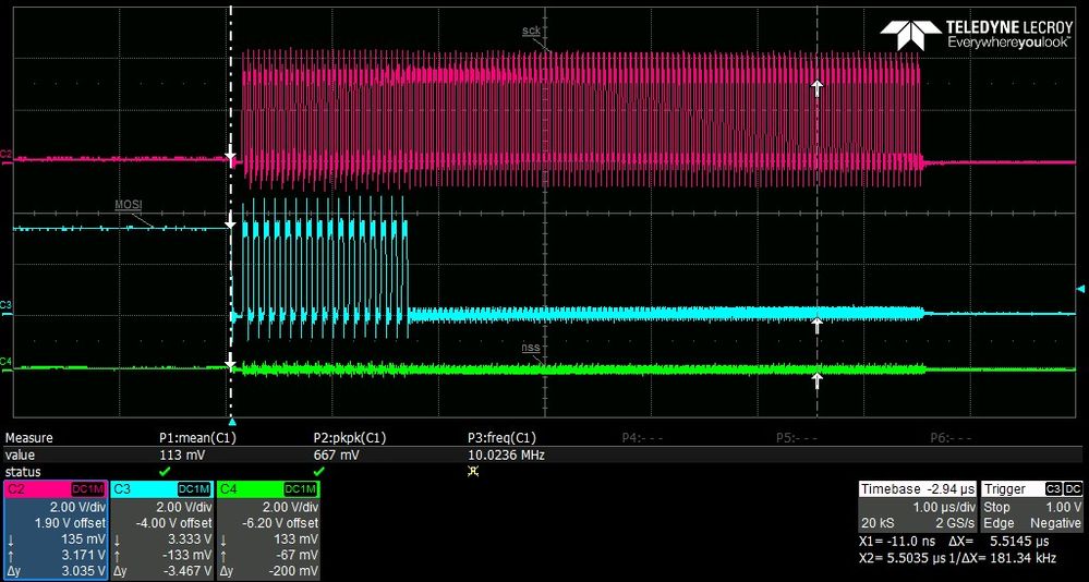

We did some more debugging and found the following:
Using hardware NSS with DMA and NSSP mode enabled, the NSS is handled by the peripheral as expected(See image), just that the NSS is deasserted between the datawords. This is not what we wanted but it's usable, without controlling NSS in software ;).

2022-09-13 2:18 AM
