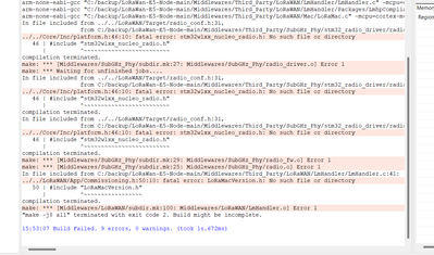

I downloaded Seeed-Studio LoRaWan-E5-Node, and all works fine till I use the MX component to set up microcontroller configuration (for example, set up LoraWAN or I2C). When I use the MX component and decide to generate code after changes to LoraWAN or I2C components, I always get many build errors. How to avoid such a situation?

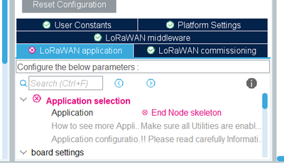

Next, I opened the MX component and made some changes to the microcontroller configuration. I double-clicked on the LoRaWAN_End_Node.ico, and made changes to the LORAWAN settings.

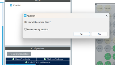

Upon closing the MX component, it asked me to generate code. I answered yes.
I tried to build the project, and I got several unexpected build errors.

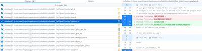

After saving code from MX I see:
