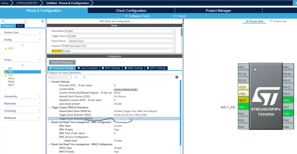

Hi @arjun.binu , you want the ADC to be triggered when the TIM1 update event happens.
In PWM center aligned mode , the update of TIM1 (when the counter rollsover) happpens right in the middle of the PWM.
Tell me which specific STM32G030x are you tring to use and which ADC TIM pins.

This is how you set the TIM1 pwm

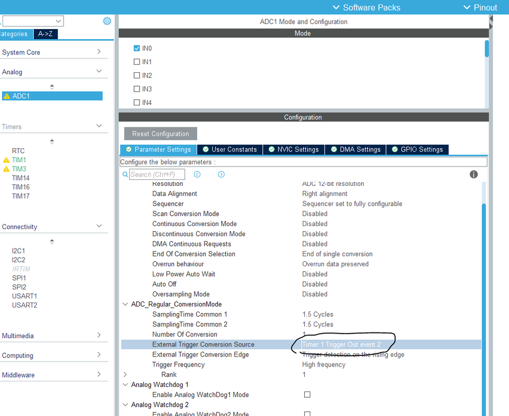

This is how you set the adc

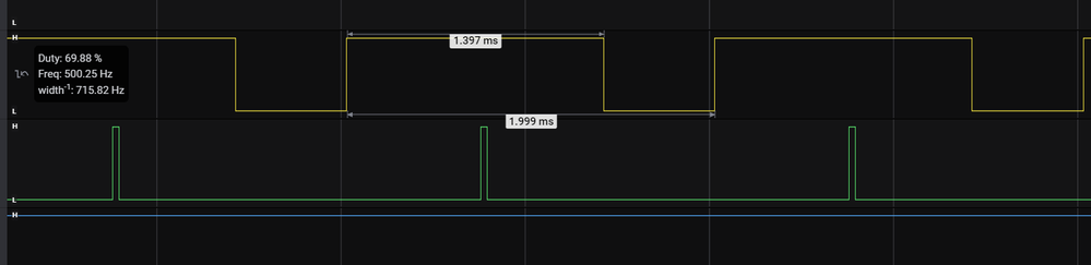

@Javier Muñoz I have tried out the above configurations.
Attaching the report generated from .ioc for your reference.
If I set CCR2 by directly writing to register like TIM1->CCR2 = 30, then I'm getting a PWM pulse of duty cycle 85.
I'm not able to properly confirm if it is center aligned PWM.
I would like to generate a center aligned similiar to the one shown below:
