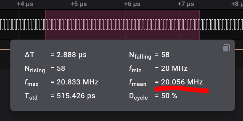

I tried this and am a bit unimpressed at the speed.
I'm running at 480 MHz clock speed. STM32H743 board. Instruction cache enabled.
I wrote the following code:

0x800919a <main_cm7()+202>: b.n 0x8009182 <main_cm7()+178>So, one str instruction per line.
The result is a PWM at around 20 MHz
So no, you can't reach 15ns. Lowest you can get is around 25ns. At least on the chip that I have.

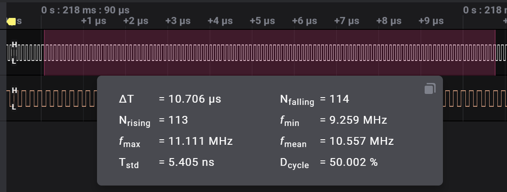

Turns out that's even more limited than the CPU transfer. This is the fastest I could get using TIM1 to trigger a DMA transfer to BSRR:
The DMA transfer error gets set as well, due to the underrun.
Theoretically, BDMA should be much quicker at this but I don't see a way to set a periodic trigger for the transfer.

>Turns out [DMA is] even more limited than the CPU transfer.
The write from DMA has to traverse almost the same bus matrix structure than write from CPU (okay, somewhat less, but on the slower side of the chip), plus DMA has to perform the memory-side read and arbitration. So raw back-to-back write speed is less.
Latencies in real program may be better than toggling pin in interrupt, that's the real value of using DMA.
