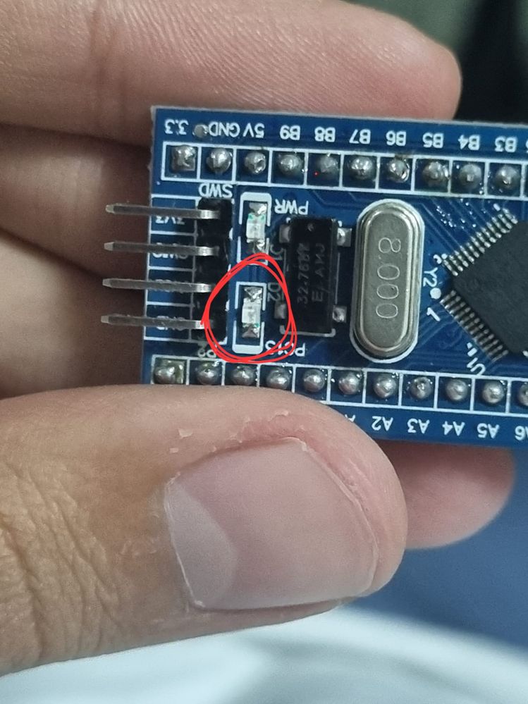

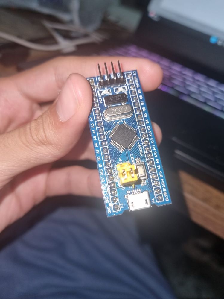

I'm a starter in embeded systems and my teacher told me to write a code for this stm32 and add a button to in on breadboard then it needs to toggle with it ( one push on button turn on the light r5 or pc13 and another push to same button turns off the same led ) I'm sure its a easy task to do but as a person don't knows anything about writing a code or work with embeded systems i couldn't find it anywhere i hope someone can help me with that (also i bought a udemy course too but it starts all started its good to learn but i need to do this in hurry. I've been working on it like 2 or 3 days and how fast im complete how good its going) Thanks All Of You !!!

That's a so-called "BluePilll", so (almost) certainly contains a fake STM32.
Your teacher would do better to get you Nucleo boards - which come complete with a button, and a built-in ST-Link.

The cpu on your blue-pill looks genuine, as far as i can see it on your pic, so it should work with an st-link .

not an another led . led on board which is connected to pc13 which is blue (there is only 2 leds red and blue) i mean.
