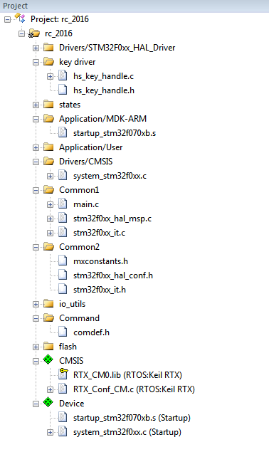

I do appreciate your suggestion.My application is not much wide, I want to delete DMA and I2C part.I did inactive in this way, //#ifdef HAL_DMA_MODULE_ENABLED // #include ''stm32f0xx_hal_dma.h'' At the beggining of this fille, #define are inactivate using /*, am I wrong ?Even I did so, there is no change on the build output !For your kind information, I did 1. This code was build in Coo-cox environment, I have modified some of its part after changing its main MCU pinout in cubemx.2. What I have modified is, its tim.h. spi.h, gpio.h, files combine in one main.c file. Remove I2C h file. some time I did #include #define. 3. Make changes in mxconstant.h file, as we changes GPIO in cubemx.Do you feel mdk keil making problem in creating folder, take a look this project tree.2016-12-10 10:38 AM

It was a problem where I was trying to build my custom stm project in mdk-keil.
Things we avoided, due to compiler did not compile files from Visual studio.
Keep in touch, this cause may arise in Eclipse again.
