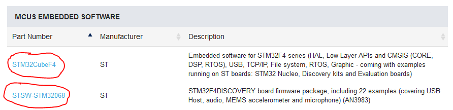

Hello!
you can go to
page and to download the firmware package alone and as optional, the STM32Cube to produce initialization code for IAR EWARM.Regards
e.f

Hello
AHAMAD.GULFAN
,Try to start from a working example available in the
package or and you may update the example according to your needs.You have a list of 'Getting started' documents in this
that may help you.Also, you can use STM32CubeMX tool to build your projectand generate an initialization code witheasy configuration.
