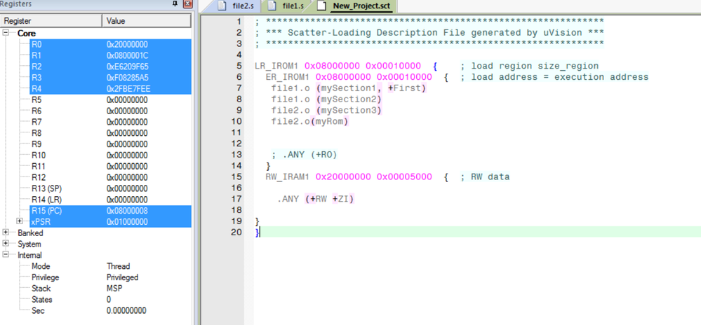

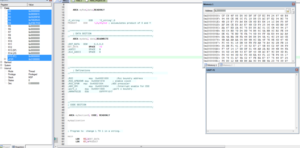

i have an stm32f103 with me ,basically when i run it on keil in simulation mode , i have allotted space in RAM to store variables and data in the picture below ,and although when i look at the address where ram starts at (0x200000000), there is no data init ,
which is what i need ,when i use my mcu with stlink debugger,run it and open the same RAM location ,there's already data
stored there and after that the whole area is showing FF which i dont understand why ? does this have to do with the
scatter file ,please help me out here's my file and scatter file in assembly ,also these picture is in stlink debug mode not simulation. Although i did define AREA mydata, data,READWRITE and a space of 10

You've placed it inside the ROM Load Region, you are responsible for unpacking the data. The scatter loader usually does this for you via the call to __main which initializes the statics and then calls your code at main().

The RAM area is named with mydata , i placed it in my ram region shown below ,even then i see random data in ram when i debug ,please correct me if im wrong
