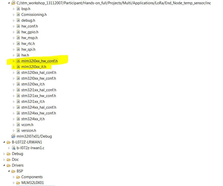

i think that i have to make these 2 files but want somebody from ST to verify ..

Those files relate to the L0/SX1276 used in the Murata Module, the others tend to describe L0, L1 and L4 on the NUCLEO-64, using the SX1272 or SX1276 shields.

There are a handful of .C files which need localizing for the given STM32 family along with pulling in the HAL libraries for the specific platforms.
stm32f3xx_hal_msp.c
stm32f3xx_hw.c
stm32f3xx_it.c
startup_stm32f3xx.s
stm32f3xx_hw_conf.h
stm32f3xx_it.h
your_bsp.c
your_bsp.h
You might need to make additional tweaks for HAL/STM32 specific difference in other source files where the API diverge
