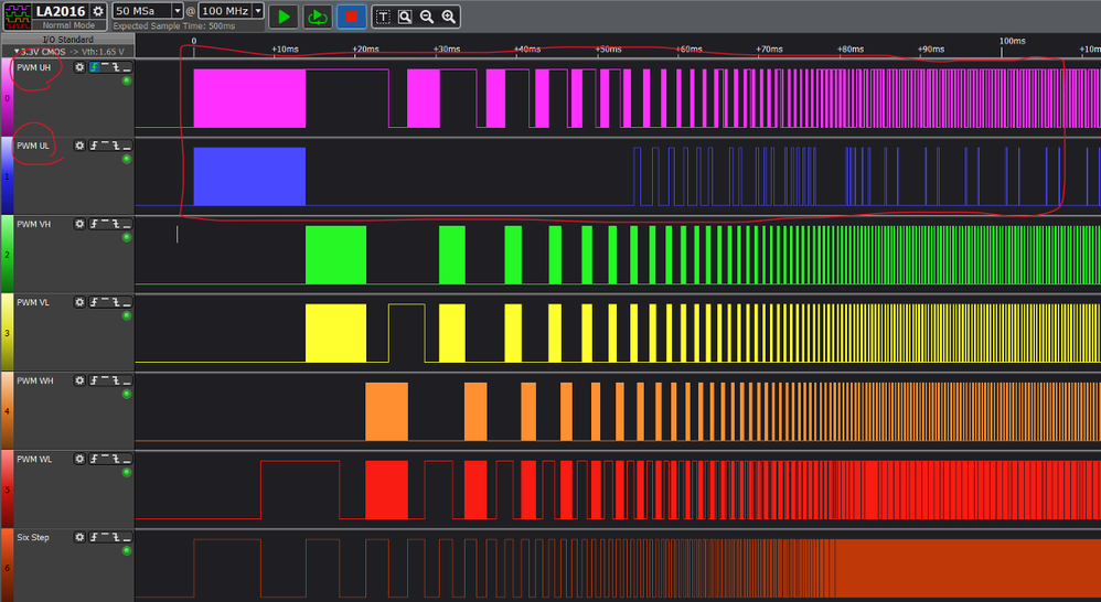

I'm using TIM1 CHx/CHxN complementary PWM output for 6 pwm signal, like below:

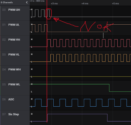

The problem I have is that the PWM output does not switch synchronously when switching steps, like below:

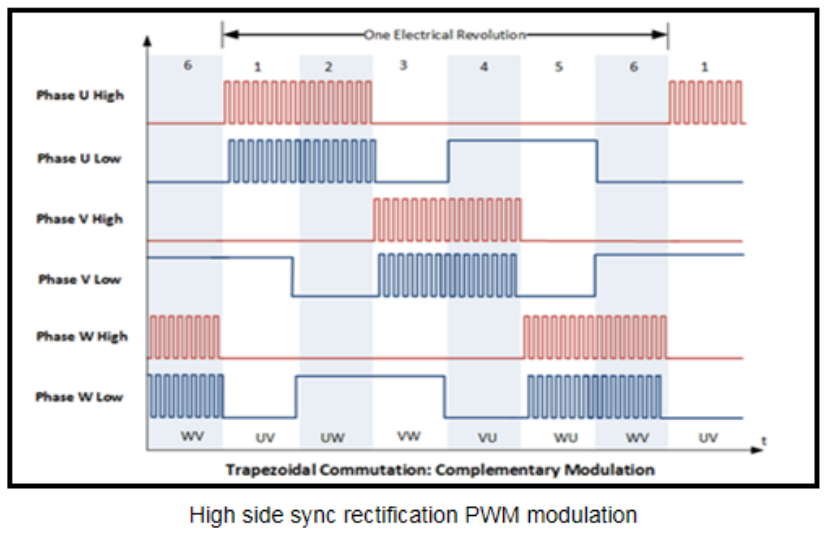

The desired switch looks like this:

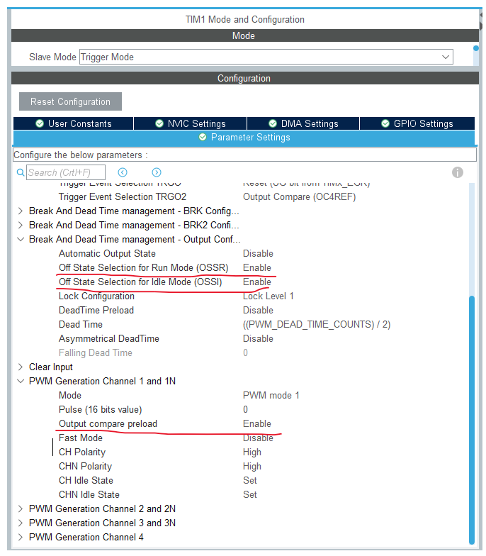

My setting for TIM1 PWM:

2021-04-19 2:54 AM
Hi Javier-san
#.1 The way to set low both PWM-UL and PWM-UH is to write code like this:
htim1.Instance->CCER &= (uint16_t) ~TIM_CCER_CC1E;
htim1.Instance->CCER &= (uint16_t) ~TIM_CCER_CC1NE;But this code not not switch properly like below:
#2. To switch properly, I can use this code.
TIM1->CCMR1 &= TIM_CCMR1_OC2M;
TIM1->CCMR1 |= TIM_OCMODE_FORCED_INACTIVE;But when use this code, the PWM output cannot be restarted as shown in the figure.
