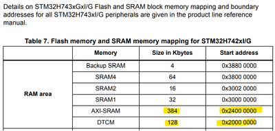

I'm having weird problems with code crashing, perhaps related to how I have IRAM1/IRAM2 set up in my project:
Looking in the reference manual, I see that the SRAM starting at 0x2000_0000 is the DTCM_RAM on TCM interface (data RAM?), the SRAM starting at 0x2400_0000 is the D1 domain, AXI SRAM but I don't see any documentation for how big either of these are. I also can't figure out what is meant in Keil by IRAM1 vs. IRAM2 (Google is not very helpful), although I suspect that question might not be within the scope of the STM forums...
If anyone can help with this I will really appreciate it!

Memory sizes are in the datasheet and reference manual.
You have AXI SRAM set to 0x80000 but its size is only 0x60000. Could be the issue, could be issues with the code itself.
IRAM = internal RAM. This is Keil terminology.

384K = 384 x 1024 = 393216 Bytes (decimal) = 60000(hex)
1K = 1024Bytes (decimal) = 400(hex)
