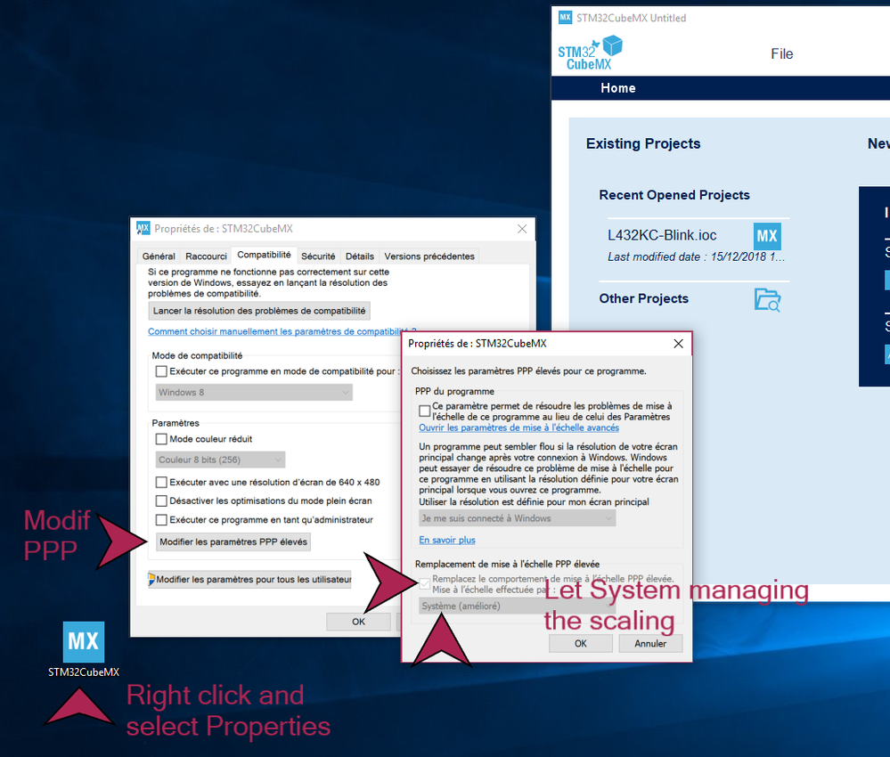

I installed CubeMX. It works but the font of the editor is so tiny that it is not possible to use it. How to enlarge the font of the CubeMX Editor?
2018-12-15 4:44 AM
I have finally found a solution under Windows 10: let the system to manage the scaling of the application STM32CubeMX cf. screenshot below.
