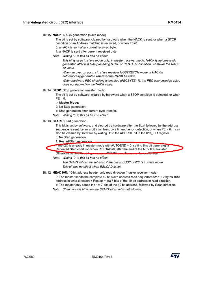

The described condition is called Repeated Start, and generally you achieve it by setting the START bit during the acknowledge phase. Details may depend on the particular I2C module (there are two distinct I2C implementations across STM32 families), e.g.:

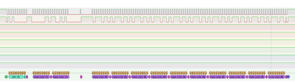

I have tried with HAL_I2C_Mem_Write function. In fact, I am using that function to write data to the fram. But I do not see the second start bit you mention:
I see the device address (First byte right after the START bit), 2 bytes for the place where the data will be stored and the data. After the data, the STOP bit signal.

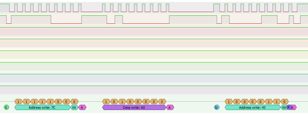

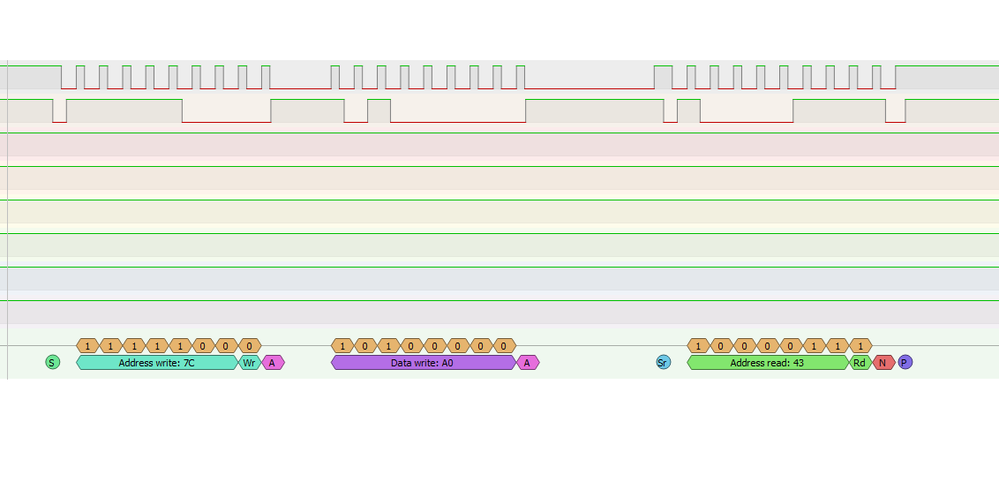

In case I use a READ operation, I see the sequence fine but I receive a NACK at the end because of the bit flag changeg for the last byte:
After changing the READ operation by a WRITE operation:
The device sends the STOP bit before receiving the ACK from the slave. I cannot understand why this happens. Any idea? I am pretty sure it has to be a very silly issue.
Ok sequence for READ:
MODIFY_REG(hi2c->Instance->CR2, ((I2C_CR2_SADD | I2C_CR2_NBYTES | I2C_CR2_RELOAD | I2C_CR2_AUTOEND | (I2C_CR2_RD_WRN & (uint32_t)(I2C_GENERATE_START_READ >> (31U - I2C_CR2_RD_WRN_Pos))) | I2C_CR2_START | I2C_CR2_STOP)), \
(uint32_t)(((uint32_t)sleep_command_2) | (((uint32_t)hi2c->XferSize << I2C_CR2_NBYTES_Pos) & I2C_CR2_NBYTES) | (uint32_t)I2C_AUTOEND_MODE | (uint32_t)I2C_GENERATE_START_READ));Wrong sequence for WRITE:

Current issue and what I do not know how to solve is that the reading operation requires that the bit 0 is a 1 (reading operation) which implies that I cannot send a 0x86 (10000110). In case I use the WRITE operation, I can send the 0x86 but I get the STOP bit before the ACK.
I posted the MODIFY_REG macro because it is the lowest I can go trying to avoid the replacement of the read/write bit.
