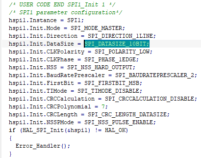

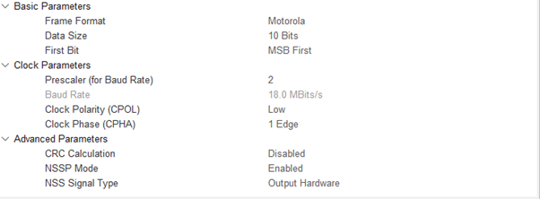

I have set the data size for the SPI channel to 10-bits in CubeMX and I can verify that that is the case in SPI initialisation structs within my code.

As for what you have suggested, I would like to provide some context and ask a follow up question. This is a dedicated SPI bus. It only ever needs to send 10-bit messages. Can I assume that initialising it in 10-bit mode is sufficient or is setting it to 10-bit after it was initialised in 16-bit preferred due to something strange to do with how the HAL or the microcontroller work.
