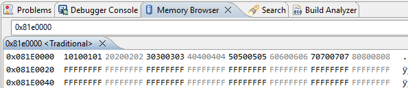

I modified it to erase the last sector of the STM32H747I MCU's flash (Bank_2.Sector_7) and program 8x32-bit words.
#define FLASH_WORD_COUNT 8
#define FLASH1_BASE 0x08000000UL
#define FLASH2_BASE 0x08100000UL
// 128KB
#define FLASH_SECTOR_SIZE 0x00020000UL
// Sector 7
#define FLASH_SETTINGS_SECTOR (7)
// 0x081E0000 start address = BANK_2.7
#define FLASH_SETTINGS_START_ADDR (FLASH2_BASE + (FLASH_SECTOR_SIZE * FLASH_SETTINGS_SECTOR))
uint32_t FlashError = -1;
uint32_t SettingsAddress = FLASH_SETTINGS_START_ADDR;
uint32_t FlashWord[FLASH_WORD_COUNT] = {
0x10100101,
0x20200202,
0x30300303,
0x40400404,
0x50500505,
0x60600606,
0x70700707,
0x80800808
// Program
HAL_FLASH_Unlock();
SCB_DisableICache();
if (HAL_FLASH_Program(FLASH_TYPEPROGRAM_FLASHWORD, SettingsAddress, ((uint32_t)FlashWord)) == HAL_OK)
FlashError = 0;
HAL_FLASH_Lock();
SCB_EnableICache();The example works great!.
