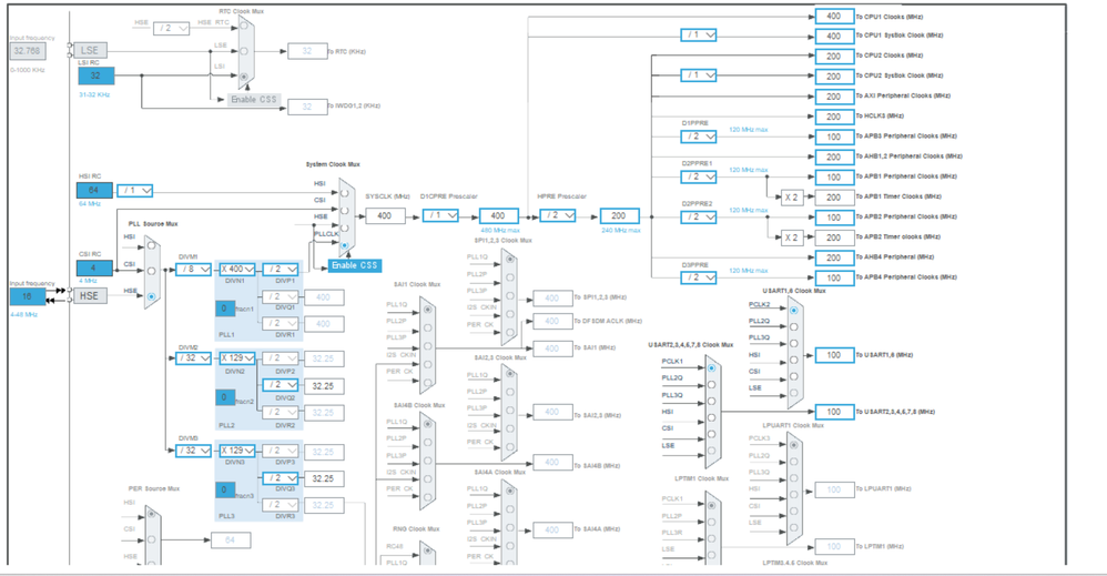

When I set the baud rate above 1M baud rate it doesn't work. Below is the clock configuration.

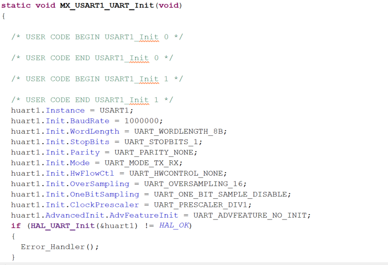

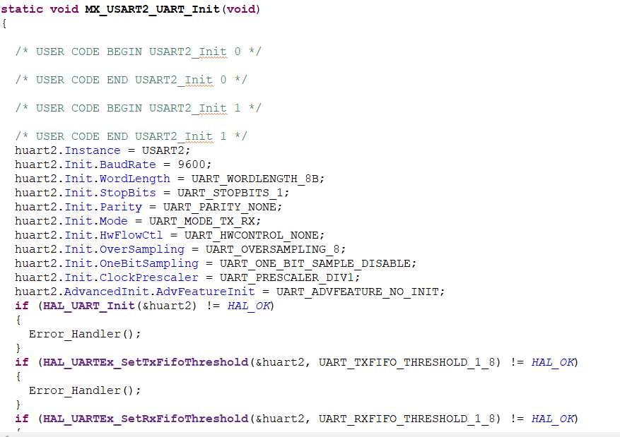

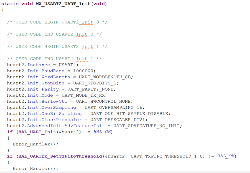

And here is the UART configuration.

As the rates increases the frequency error can get larger / rougher. You want a bus clock that's closer to a multiple of 16 MHz for 1 MHz, in 16 Over mode.

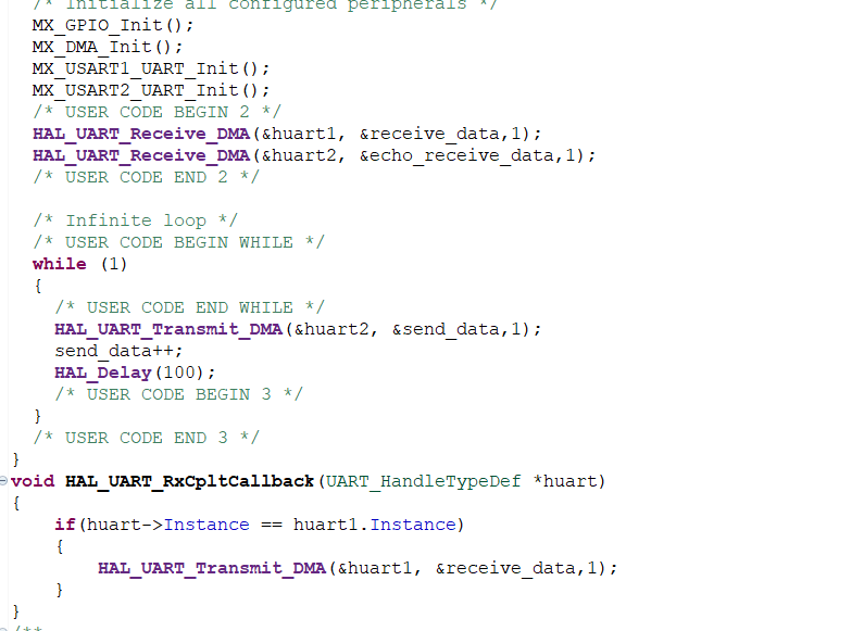

Below is the code that performs the transmission and reception.
The problem is when I increase the baudRate to 2M the variables send_data, receive_data, echo_receive_data do not change. When I set the BaudRate to 1M, the variables change, proving that the UART is working.

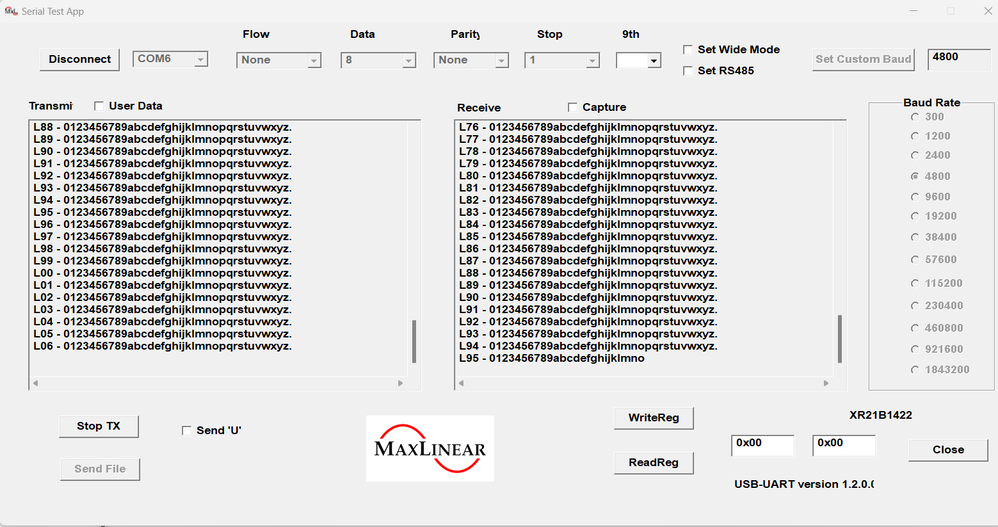

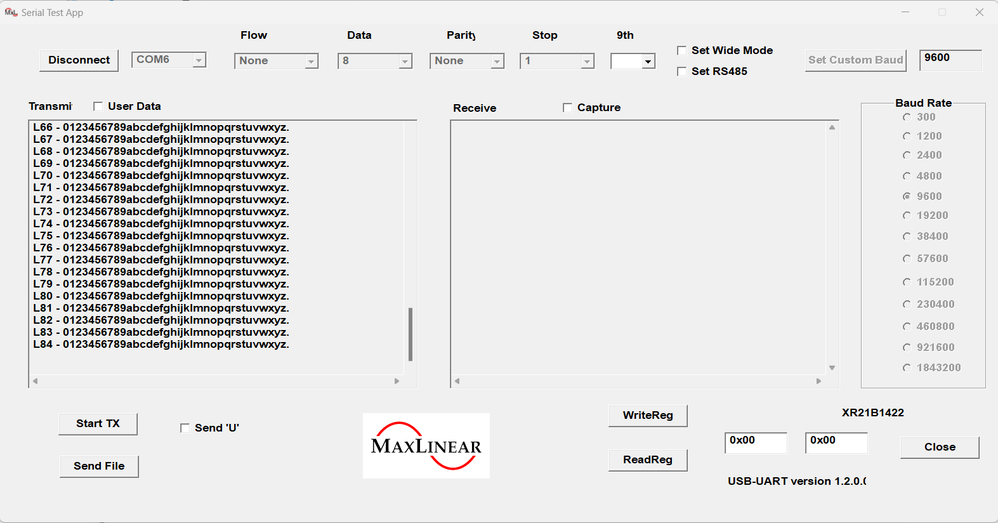

I tried using baudrate 9600 and connecting to Maxlinear's XR1422IL to transmit and receive to the PC.
However, another problem arose. That is, on the computer, the baudrate must be set half lower, specifically 4800, to communicate successfully.

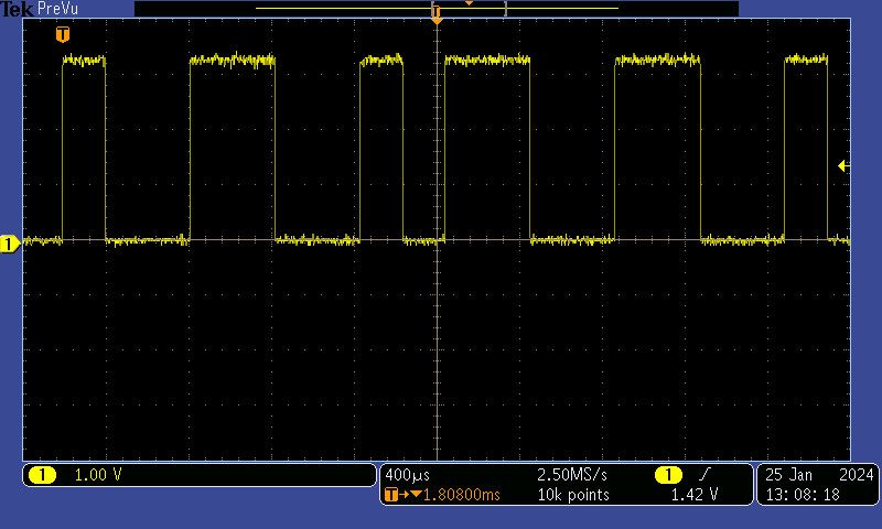

Below is an image of unsuccessful communication between the H755 on the nucleo kit and the XR1422IL of MAXLINEAR, when the baudrate set on the software is 9600.
Below is an image of successful communication between the H755 on the nucleo kit and MAXLINEAR's XR1422IL, when the software baudrate is set to 4800.
I also measured the TX pulse of the H755 but didn't find any problem.

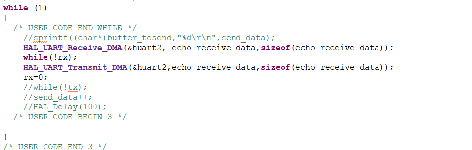

Below is the processing code on H755
