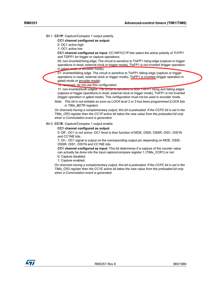

Change polarity of one of the channels, using TIMx_CCER.CCxP.

It worked perfectly.
I'm not sure I understand why it worked though. I don't see how switching channel 1 to Falling edges would reverse counting.
It inverts the whole signal, thus rising edges become falling and falling edges become rising.
