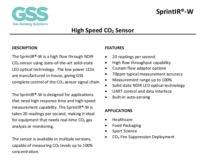

2022-11-20 12:56 AM
hi,
please find the attachment of co2 sensor datasheet image.

2022-11-20 8:14 AM
The reason your reading 0 is because you didn't send a command to read a register. Your HAL_UART_Receive(&huart2,(uint8_t *)BUFFER,sizeof(BUFFER),100) times out in 100ms. You also don't read the HAL return status so you didn't see it return HAL_TIMEOUT. So you may think the STM32 received 10 bytes but it didn't.
Then there are return values are in ASCII and they are not consistent in length so reading 10 bytes is not going to work. HAL_UART_Receive_IT(&huart2,(uint8_t *)BUFFER, 1) is going to work better for you. You need to fill your buffer one character at a time until until you receive a CR and LF.
You need to read the data sheet more thoroughly especially UART COMMAND PROTOCOL section.
